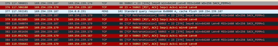

Then I tried to analyse the communication between my laptop and the Teensy 4.1. I compared it to the Arduino Uno. The difference is/was that TCP works great with the Arduino, but somehow it doesn't want to work with the Teensy. Here is a small cutout out of wireshark : I tried to get the connection with PuTTy. And this is the result
After this wasn't working, I tried to figure out where the problem is.
So I decided to try if the WebServer example works, because I use port 80 here and HTTP.
This worked well.

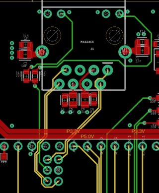

The configuration of my ethernet part of the PCB:
Could anybody help me out? I appreciate every hint!
