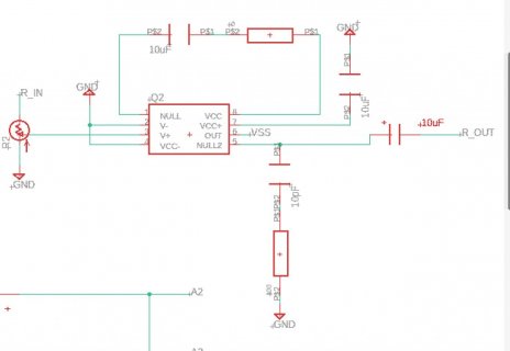

I’m also not entirely sure if my hardware setup is working correctly. For this, I’m taking an audio input from my phone, running it through a preamp, then running it through the circuit that was detailed in the adcs section of the audio library. When I measure the DC value of either analog pin with a multimeter, it reads 0.604 Volts. My preamp gain is adjustable rn, but I can adjust the AC RMS voltage to be at around 400 mV, which is what I have it at now. I can make this bigger though. I’ve got everything on a PCB rn, and it seems like I’m getting an audio signal there. I’ve attached my schematics and code below.

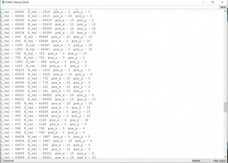

This is a log of the ADC values I'm getting when no audio is being played. This is very odd because I'm getting massive values when it should be sitting at about the halfway point. I would also think the value would stay relatively constant. Note that the two leftmost values are the ADC raw audio data from left and right channels

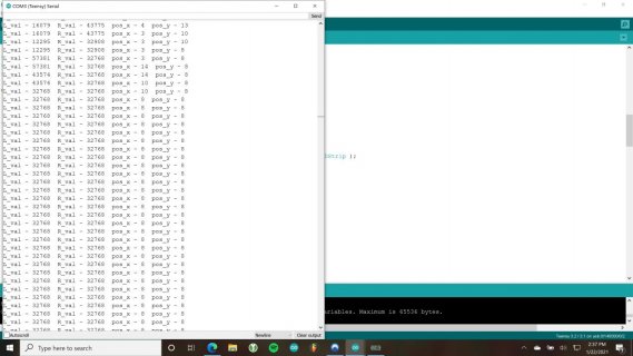

This is a snippet of the values when audio is being played through the audio jack

this is my preamp circuit. R_in is the right input of an audio jack. I'm using an LM358 op-amp. This circuit came from an amplifier prototype board I bought. There's an identical circuit for L_in as well.
Here's the buffer circuit that was described in the documentation. This is fed directly into the teensy analog pins A2 and A3.
The ADC values are signed 16-bit. This is why you see the large values such as 65369, it is actually a small negative number.

The AudioInputAnalogStereo update function performs DC offset removal which, in effect, converts the unsigned 16-bit integer from the ADCs into signed 16-bit integer. I presume that this is to make the ADC data compatible with the other functions in the Audio library which all assume that they receive int16_t data.
