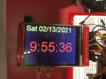

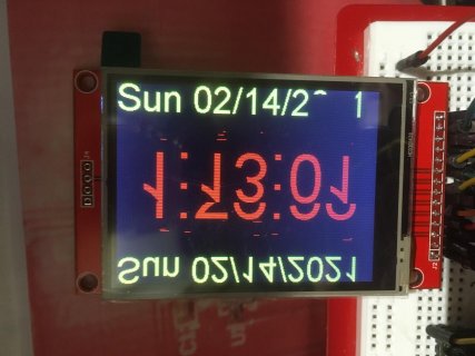

ILI9341 Display craziness after long run between screen refreshes
paynterf
I have a simple clock program running on a new ILI9341 from the PJRC store (code included below), and it seems to be working fine. However, after several hours of run time, it starts to show some artifacts in the blank areas, and then some hours later it starts displaying 'ghost' images of the intended date and numbers.
When coding the application, I initialized the screen with 'tft.fillScreen(ILI9341_BLACK);' in setup(), but deliberately didn't refresh the background in loop(), to avoid the annoying 'blink' each time the background refreshed. Instead I used ' tft.fillRect(x,y,h,w, ILI9341_BLACK);' to just overwrite the sections of the screen used to display the date and time information. Apparently something along the line is losing synch with where it is supposed to be writing to the screen, or something.
Here's the code:

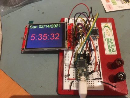

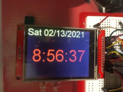

And here are some photos of the screen acting normally, and then as it progressively gets worse
Normal Display:
Start Seeing Artifacts:

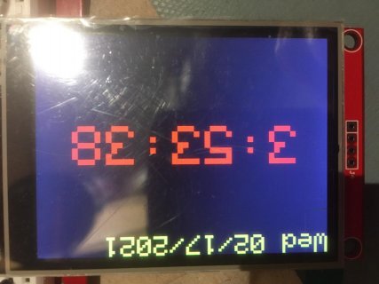

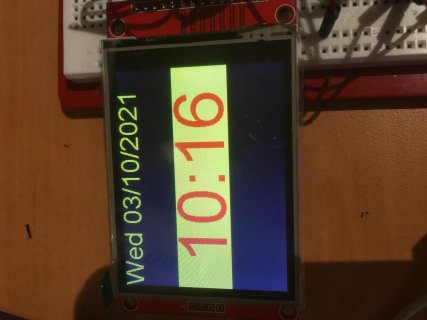

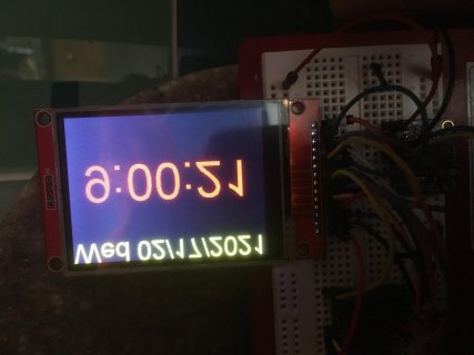

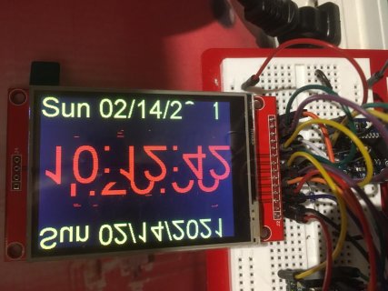

More Artifacts:
Complete Craziness:
I know (or at least I think) I can avoid all this by refreshing the entire display every second, but then I have to put up with that annoying 'blink'. Is there any other option here?
Frank

Since it is on a breadboard with long wires I suggest trying a slower clock, 10 mhz or slower: // tft.setClock(10000000);
It could be a faulty display that forgets its rotation setting. You could refresh that each second to see if that makes a difference.
Or maybe your power supply is too weak.
I had a similar problem with my Teensy 4.1 and Adafruit HX8357 display. It went to inverse colors and a mirrored image. It turned out to be a loose connection. I reseated the connectors and the problem went away.
The problem seems to be related to the use of the Arial proportional font. I changed to non-proportional text and it seems to be working well. After about 6 hours I see no artifacts at all, without refreshing the entire screen at all (I only refresh the rectangles associated with the text I want to display, to reduce the amount of 'blink'.
The date & time text doesn't look anywhere near as good as the Arial proportional font, but I'll take that to avoid the artifacts and mirroring ;-).
Regarding the other poster's thoughts about connections and clock speeds - not sure how that would affect the font display, but I'll try lowering the speed and see what happens.
Frank
So, I let the clock run overnight with no hourly refresh, with the non-proportional font, and it is still OK this morning. So, there is definitely an issue with the proportional font (memory leak?)
