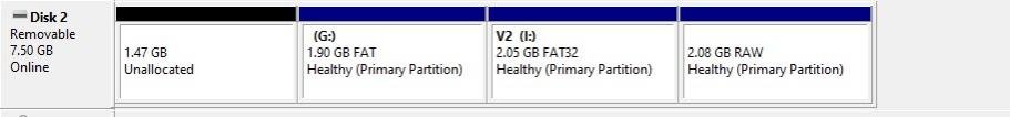

Ran into one problem when wanting to specify new partition. In writeMBR function we specify:
  MbrSector_t* mbr = reinterpret_cast<MbrSector_t*>(m_secBuf);
  [COLOR="#FF0000"]MbrPart_t *pt = &mbr->part[/COLOR][m_part];
So as usual got stuck on if a new part how do we point it the new part? Or am I making it more complicated.
Yeah making it more complicated - just need to use the original writeMBR function I think. The writeSector should take care of where to write.
@all - just pushed up new branch on UsbMscFat - add_partition
That has the hacked up code mentioned above. WIP,
but it did appear to be able to add MBR for my 1gb thumb drive which I deleted everything earlier.
More testing needed and probably move code out of sketch into appropriate places.

As a experiment (by the way figure it would work this way) I took my 4 part 128gb drive:
msc # Partition Table
	part,boot,bgnCHS[3],type,endCHS[3],start,length
FAT32:	1,0,0x20,0x21,0x0,0xC,0xFE,0xFF,0xFF,2048,61675520
	 < unused area starting at: 61677568 length 60817408 >
exFAT:	2,0,0xFE,0xFF,0xFF,0x7,0xFE,0xFF,0xFF,122494976,68661248
FAT32:	3,0,0xFE,0xFF,0xFF,0xC,0xFE,0xFF,0xFF,191156224,50868224
pt_#0:	4,0,0x0,0x0,0x0,0x0,0x0,0x0,0x0,0,0
and ran my create partition code - well it sort of worked:
	 < unused area starting at: 8192 length 61669376 >

Actually it looks like you did maybe preserve some with previous code. Will setup the test again and see what happens with new stuff...
In this image the G: was the one I think was the new second drive, V2 is still there from before and the last one is still free... Will again investigate more.

I will play more with the fill in the holes code...
