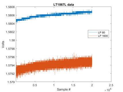

    I dug out my LT1867L board and recorded a data file with all 8 channels connected to a 1.5V alkaline battery and sampled at 4000 samples/second. Data from each of the first four channels passed through an 8-pole IIR Butterworth low-pass filter implemented on the T3.6. The filtered data was rounded and stored as uint16_t values on the SD card. Here is a plot of a portion of the data: LP80 is the channel with the 80Hz low pass filter. LP1600 has the 1600Hz lowpass filter.
    As you can see, oversampling and filtering works well. The T3.6 has the horse power to do the filtering while sampling and that allows you to use the data for control as well as just storing it for later analysis (as I did in Matlab to generate the plot).
    The OP didn't specify exactly what sample rate and number of channels was needed. However, I think the T3.6 could probably handle 4 channels sampled at 10KHz. Filtering and decimation to store 4 channels at 1KHz should be possible. That's really more like low to medium speed compared to the 1Megasample collection that has been demonstrated on the T4.1.
