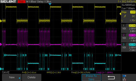

I'm got some proof-of-concept code to interface to these ADCs, which are SAR 18 bit 400kSPS (ie
_not_ sigma-delta so have very low latency, and a 1.2µs settling time to 18 bits) They are not I2S,
note.
datasheet: https://www.ti.com/lit/ds/sbas568a/sbas568a.pdf
I already had a test board for these I'd been using on another microcontroller for playing around with
spectrum analysis (cut down dynamic signal analyzer, basically).

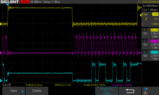

To get them working at the highest speed for audio sampling (384kSPS), the timing is tight as there is
a 1.3µs conversion time before 18 bits can be clocked out at a maximum of 16MHz, all having to fit
in about 2.5µs.
And of course for spectral analysis the aperture jitter is crucial at 18 bit resolution, so its vital to trigger
the start-conversion pin precisely regularly.
I thus have figured out how to use FLEXPWM to drive the start-conversion pin and trigger an interrupt
from which the bits can be clocked out.
Thought I'd share the method I've used, which involved figuring out how FLEXPWM is driven in pwm.c

 * PWM driven regular sampling via a pair of ADS8885 SAR 18-bit ADCs.  PWM hardware
 * ensures the aperture timinng is consistent (the chip has jitter of only 5ps, which is good
 * to 19 bits resolution if driven from low-jitter CONVST clock)
 * The PWM compare interrupt is used to then drive the serial transfer once the 1.3us acquisition
 * time is complete - this should be done with SPI hardware really.
 * This sort of ADC has enough resolution for audio, is fast enough for 384kSPS, and has an
 * 18-bit settling time of 1.2us, so could be useful for ultra-low latency processing if coupled
 * with a non-sigma-delta DAC

// The ISR - at this point the PWM'd CONVST pulse has just ended.
void pwm_irq (void)
  PWM_status = 1<<PWM_cntbit ;  // clear interrupt flag
  inner_read_ADC() ;

Not being sigma-delta these ADCs can be calibrated accurately to a voltage reference, which allows
precision measurements to be made in a way most audio conversion chips cannot. I think the spec on
the chip is +/-0.01% accuracy given a good reference. The thermal gain drift is 0.15ppm/C, and THD
- 115dB (despite being SAR technology, its no-missing-codes and ultra low distortion)
