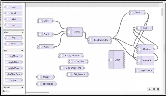

Hello,
I have started putting a Teensy synth together. It has analog pots and switches, all working, connected to a teensy 3.5 with audio shield.
The overall design target is: 3 oscillators (Two and Three are pitch and volume selectable, Three is octave selectable, and all three are waveform selectable) one LFO with four destinations, ADSR, filter with cutoff and resonance, and finally delay and reverb.
I've been getting it up step-by-step with success: first the oscillators made pitches through the headphones, their level controls seemed to work, the sound was smooth, choosing different wave types was fine, etc. No crackles or pops or artifacts or whatever. Just neat sounding synthy waves of different kinds happily mixing together.
Then I incorporated the filter and it seemed ok, too- though there was some crackling when i swept the cutoff knob around, it wasn't too terrible and I decided to keep going. I used the mono reverb from the Audio library and got a wet/dry knob working well for that. In fact, the crackling helped me hear the quality of the reverb!
Then, I got midi in to work and print midi messages to the serial monitor (one of the projects on Teensy website, the example midi input one here: https://www.pjrc.com/teensy/td_libs_MIDI.html
...I also used the schematic to wire my MIDI IN port.)
Currently, the synth 'works' (and I'm pretty excited about it, it's my first try ever) but there is quite a delay between pressing a key on my midi controller and the wave changing; there is no note-off yet; and there is some weird stuff going on with the pitches and if i just leave a note on there is quite a bit of crackling here and there, stuff I associate with 'code not working correctly' because I tested all the hardware and there was very good sound quality back when it was just waves, oscillators and so on. In other words, I'm not overdriving one of the mixers or anything. And the distortion in the filter is unrelated to the amount of resonance- it happens when the resonance is well below the stated .707 threshold.
I haven't done the LFO yet, or the ADSR envelopes, or the delay. But I'm a bit stuck where I am.
Code-wise, there's no doubt I have made a mess of things because I simply know nothing about how to run code efficiently. So I am hoping to post it here and pray for some GENTLE advice about:
1. the best coding approach to efficiently and usefully change midi note to frequency and set my OSC1 to that frequency
2. any comments about my filter implementation and why that step introduced some crackling
3. any guidance about how to figure out (for a newbie) voice allocation or just how to get MIDI on and off working cleanly, at least mono for now
4. any stuff in advance to look forward to with ADSR envelopes and getting the delay (time, wet/dry) to work...for now, I didn't want to get into multiplexing for this first synth so I have only a few knobs and decided to eschew delay feedback on this one
The problem is the huge gap between my ability to read and understand, say, the code that the Teensy Tsynth runs (way too complicated for me to follow) and other examples of midi synths I'm trying to use and borrow from. I really do need help in the most basic stuff- how functions return values, how to make the main loop of code run efficiently, etc.
There are ABSOLUTELY bits of code floating around that I'm not using but were left over from stuff I cut and pasted and tried out...for example, I left some things in for voice allocation to 8 voices even though at the moment I'd be fine with a working monophonic synth.
I'll try to post code correctly here and hoping i sorta get the tags and stuff right. Thanks!

AudioSynthWaveformModulated Osc1;   //xy=129,88
AudioSynthWaveformModulated Osc2;   //xy=129,175
AudioEffectChorus        chorus1;        //xy=128,452
AudioSynthWaveformModulated Osc3;   //xy=133,256
AudioEffectEnvelope      envelope1;      //xy=136,496
AudioSynthWaveformModulated LFO_Osc2Freq;   //xy=295,313
AudioSynthWaveformModulated LFO_DelayTime;   //xy=300,393
AudioMixer4              Premix;         //xy=319,159
AudioSynthWaveformModulated LFO_Volume;   //xy=336,435
AudioSynthWaveformModulated LFO_Filter;   //xy=340,351
AudioFilterStateVariable LowPassFilter;        //xy=479,212
AudioEffectDelay         Delay;         //xy=589,340
AudioEffectFreeverb      Verb;      //xy=723,35
AudioOutputI2S           i2s1;           //xy=771,134
AudioMixer4              MasterR;         //xy=776,345
AudioMixer4              MasterL;         //xy=777,272
AudioConnection          patchCord1(Osc1, 0, Premix, 0);
AudioConnection          patchCord2(Osc2, 0, Premix, 1);
AudioConnection          patchCord3(Osc3, 0, Premix, 2);
AudioConnection          patchCord4(Premix, 0, LowPassFilter, 0);
AudioConnection          patchCord5(LowPassFilter, 0, MasterL, 0);
AudioConnection          patchCord6(LowPassFilter, 0, MasterR, 0);
AudioConnection          patchCord7(LowPassFilter, 0, Verb, 0);
AudioConnection          patchCord8(Verb, 0, MasterL, 1);
AudioConnection          patchCord9(Verb, 0, MasterR, 1);
AudioConnection          patchCord10(MasterR, 0, i2s1, 1);
AudioConnection          patchCord11(MasterL, 0, i2s1, 0);
AudioControlSGTL5000     sgtl5000_1;     //xy=771,409

You've created the I2S output before the master mixers, so it will be run before the mixers that provide its data.
There can be issues if things are run out of order like this, sometimes, and these are often intermittent, and
the latencies and timing wont be as expected of course. Its possible this might be making some glitches, not sure
though.
If you stick to the auto-generated code from the audio design tool it puts objects in a consistent order. The audio
processing chain is run strictly in the order the audio objects were created, irrespective of connection topology.
You have calls to delay(100) - that's not a good idea if you want timeliness of response.
Thanks! I did use the auto generate tool and did not alter what it created. And afaik the function with the delay in it is not called atm (it was part of an attempt to learn how multiple voices are assigned) but I will comment it out and make sure. Not sure why the audio tool generated the objects in the order it did...
Sounds like there's a bug? Or maybe I was wrong about it generating a breadth-first traversal (which is what the
Audio library seems to assume).
Thinking about it there's perhaps an assumption that if the signal wire runs backwards (graphically) its a cyclic link? Certainly
flattening the graph has to have some source of information about which links are "backwards" in any cycle. Those
links will have a block's worth of latency. Not fluent with JS though so don't really relish delving through the audio
tool code.

Can you provide any guidance about whether, in this exact design (three oscillators with three waveform types each) there are benefits to wavetables vs. using the modulation-ready oscillators in the audio library? And then, when does it become necessary or clearly more efficient to use wavetables? My next design has a fourth sound source using FM, and I'm pretty sure the arduino project i am swiping it from used wavetables. In this design, one of the waves will be modulated by an LFO, but that is it so far.
You can use AudioProcessorUsage() and AudioProcessorUsageMax() to instrument your code and see what the
audio lib CPU load is for various configurations.
