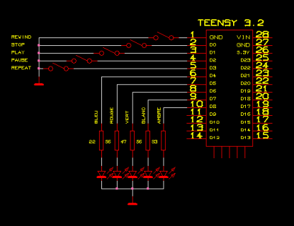

You did not show your wiring, but from your code, Im going to assume that you have the 5 buttons wired to pins 0-4 & the 5 LEDs wired to pins 5-9.
I did not load your sketch into a Teensy, nor did I attempt to reproduce your hardware setup, but I noticed the following: the first "for" loop in your loop() function is incorrect. Your terminating conditional should only go to "i < NB_PADS" (just like all of the other loops). Try making it look like the following & report back whether or not it behaves any better:

Hi Mark,
Your assumption is correct :)
Here is the schematic. For information this will be a MIDI control surface, I have removed all the MIDI stuff for more clarity.
You are right! +1 has nothing to do here. Removing it makes the LEDs to remain illuminated.
However, it still doesn't work with the following code. Pushing a button does nothing (and MIDI control messages are not sent) as soon as SoftPWM is used, but works fine with digitalWrite.

@Jibeji - you made a new thread I see ...
T_3.2 has PWM driven Analog pins. I just wrote this on a T_4.1 for A9 or pin 23 the T_3.2 has as well.
	while (!Serial && millis() < 4000 );
	analogWriteResolution(12);
elapsedMillis tLED;
int aVal=96;
	if (tLED > 100) {
		tLED = 0;
		analogWrite(23, aVal);
		aVal += 100;
		if (aVal>4096) aVal = 96;
Will need to alter the way pins are accessed from #0 through #9 to #0 to #4 to perhaps #19 to #23 for PWM analog usage.
Indexed from an array :: int tenPins[10] = { 0,1,2,3,4,19,20,21,22,23 }
Then recode loops like : pinMode ( tenPins, INPUT_PULLUP);
In the loop you set the SoftPWM to the input pins and not the output pins. Will not give any light effects and most likely confuse the inputs also.
Yes, like before in the other thread for the outputs:
for (int i = NB_PADS; i < NB_PADS+NB_PADS; i++) {
But - using analogWrite ... with those correct offsets ... should be more direct with hardware support instead of added software.
