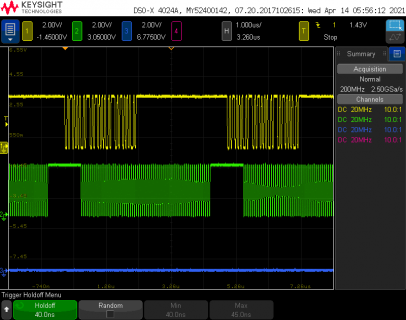

SPIFIFO isn't really recommended anymore, but I decided to give it a quick try just to see how much of the CPU time on a Teensy 3.2 would remain unused if an IntervalTimer uses it every 5 microseconds.
Here's the code I tried. Hopefully this is pretty obvious. It toggles a pin in loop(), so we can see how much of the time is spent in the main loop versus the IntervalTimer interrupt.

And here's the result my oscilloscope sees. Better than I thought it would be. ;)
Hi Paul. The bottom trace looks like 64 clocks @ 16 MHz, is that right?
The bottom (green) trace isn't SPI at all. It's from this:
  while (1) {
    digitalToggleFast(2);
The idea is to gauge how much of the CPU time is spent inside the interrupt versus the main program.
Oh wow, that's even better! I thought you were probing SCK, not MOSI. So it's more like 20% CPU usage in the interrupt.
