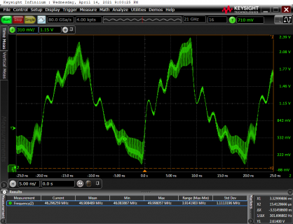

But this is the waveform I measure on pin 34:
The frequency is roughly double the target frequency with 10 ns rise and fall times.
If I use delayNanoseconds(20) instead of the sets of NOPs then the problem is the opposite:
I.e., the frequency is now half of the target frequency but the 10 ns rise and fall times remain.

Here is an update as I continue to try and solve this problem; I found the IOMUXC_SW_PAD_CTL_PAD_GPIO_B[n]_[o] registers in the NXP DS and I read their default values which are decimal 4272. The LSB is said to control slew rate speed—with 1->fast and 0->slow—so I set the 3 respective bits high in the following code update:
#define NOP __asm__ __volatile__ ("nop\n\t")
#define PIN_A  34 //Pin 34 on Teensy 4.1. GPIO 7.29. MIMXRT1062DVJ6A Pad B1_13.
#define PIN_B  35 //Pin 35 on Teensy 4.1. GPIO 7.28. MIMXRT1062DVJ6A Pad B1_12.
#define PIN_C  36 //Pin 36 on Teensy 4.1. GPIO 7.18. MIMXRT1062DVJ6A Pad B1_02.
//Takes binary # between 000 & 111 (0–7), where LSB -> PIN_A, ..., MSB -> PIN_C,
//and sets the respective bits in the register so those pins output HIGH:
void set3BitsInPort7(uint32_t threeBitsToSet) {
  GPIO7_DR_SET = ((threeBitsToSet>> 0) & 1) << CORE_PIN34_BIT  | //PIN_A
                 ((threeBitsToSet>> 1) & 1) << CORE_PIN35_BIT  | //PIN_B
                 ((threeBitsToSet>> 2) & 1) << CORE_PIN36_BIT; //PIN_C
//Takes binary # between 000 & 111 (0–7), where LSB -> PIN_A, ..., MSB -> PIN_D,
//and clears the respective bits in the register so those pins output LOW:
void clear3BitsInPort7(uint32_t threeBitsToClear) {
  GPIO7_DR_CLEAR = ((threeBitsToClear>> 0) & 1) << CORE_PIN34_BIT  | //PIN_A
                   ((threeBitsToClear>> 1) & 1) << CORE_PIN35_BIT  | //PIN_B
                   ((threeBitsToClear>> 2) & 1) << CORE_PIN36_BIT; //PIN_C
  pinMode(PIN_A, OUTPUT);
  pinMode(PIN_B, OUTPUT);
  pinMode(PIN_C, OUTPUT);
  noInterrupts();
  clear3BitsInPort7(7); //Make PIN_A, PIN_B, & PIN_C LOW.
  IOMUXC_SW_PAD_CTL_PAD_GPIO_B1_02 |= 1;
  IOMUXC_SW_PAD_CTL_PAD_GPIO_B1_12 |= 1;
  IOMUXC_SW_PAD_CTL_PAD_GPIO_B1_13 |= 1;
  delay(100);
void yield() {
  while(1) {
    set3BitsInPort7(7); //Make PIN_A, PIN_B, & PIN_C HIGH.
    delayNanoseconds(20);
But it had 0 effect (i.e., the 10 ns rise/fall times and delayNanoseconds doubling still persists). Can anybody help me with this? I feel like it is very important for any high speed I/O Teensy 4.1 applications.
