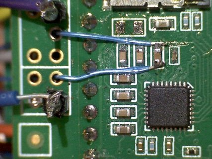

On the Audio Board, the ferrite inductor is removed and VDDA and Analog ground wires are soldered across the VDDA bypass caps.

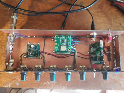

The boards are mounted in a copper-clad box which is connected to Analog ground. Digital ground is maintained as an isolated net. The two grounds connect at the AGND pin on the codec chip.

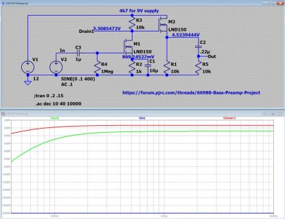

Here's what I did for the preamp. I used LND150 MOSFETs because I've been using them for other experiments - they're good up to 600V :). Other FETs would probably work fine with some resistor tweaking. I'm running the whole system with a 12V supply, so I used that voltage (with an RC filter) for the preamp. The output voltage from the preamp with my bass is typically less than 3.3V p-p with the volume pot set to max, so I haven't put any protection on the ADC input (yet). A pair of schottky limiting diodes to VDDA and Analog ground would meet the Absolute Max Voltage spec in the codec data sheet.

@John:
Thanks for sharing your schematics! (I could only open this with my PC today, not with the mobile phone.)
I own some LND150. But up to now I have only had these in mind for high voltage applications. Always learning....
Edit: Interesting: 0.22uF reduces the Amplitude for lowest tones ~40Hz significantly. So you are doing some pre emphasis too?
Edit2: With a different drain resistor together with the output potentiometer, the circuit can be tuned to soft clip symmetrically at about output amplitude 1.6V. - Makes a lot of sense for me.
Thanks for posting the simulations! I was aware of the LF roll-off issue. When I picked the 0.22uF output cap, I thought the pots I had were 25K, but it turned out they were 10K :) When I realized that, I decided to just go ahead and test it as-is before I got the soldering iron out again...
LF roll-off is one of the main things I am trying to optomize in the overall design. I want to get plenty of "thump" on (loud) low notes, but I don't want to fry my speakers :) In the design I tried this past weekend, I had a 20Hz Hi-Pass filter (SVF) right after the I2C input. My "Bass" control filter is a SVF Lo-Pass at 50Hz and the knob range is 0dB to 6dB. That seemed to feel pretty good playing with a guitar player and drummer at a rehearsal.

Here's a shot of the preamp in operation last Saturday:
This is a close-up of the mods I did to the Audio Shield. The Ferrite is removed and VDDA and AGND from the Analog 3.3V supply are connected across the VDDA filter caps:

On the Audio shield, the ferrite on the picture needs to be removed, but I don`t think I understand
Can someone explain this to me? Also what kind of RC filters are needed to be added to the inputs?
When you look at the schematic and PCB layout for the Audio Shield, there is a ferrite and two caps connected to the VDDA input pin on the IC. Removing the ferrite disconnects the VDDA pin from the existing 3.3V power on the Shield.
The SMD cap right next to the ferrite is one of the caps that connects to the VDDA pin. To get "clean" power to the VDDA pin, I tacked a wire to the "+" side of the cap and connected it to my 3.3V power supply. Ground from the 3.3V power supply connects to the other side of the cap.
