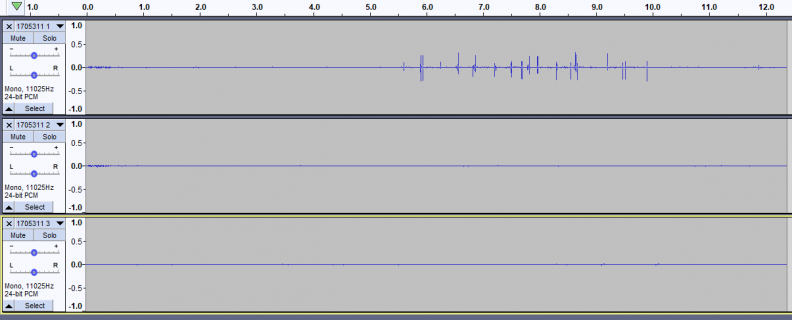

Hi. Is there any way to retrieve recording from the channel of each microphone?
I am looking to get the recording of individual microphones from a daisy chain connection
I am using daisy chain of 3 mics ( ICS-52000) with a Teensy 3.6.
I am currently using the latest code from member amperwest1
https://forum.pjrc.com/threads/5341...-with-Invensense-ics-52000?highlight=ics52000

// Record TDM input sound as raw data (16ch, Signed 24-bit little-endian PCM, 44.1kHz, little-endian) to a SD card.
// Note: Format is modified so that mics align their 24 bit data to 32 bit slots, half of the 16 bit
// channels end up being the 8 low bits, and 8 more zeros which are discarded.
// Hardware:
//   Mic Pin 6  (SD_O)  to Teensy Pin  13 SDATA  (Input, 11.3 Mbit/sec)
//   Mic Pin 8  (SCK_I) to Teensy Pin  9 SCK     (Output, 11.3 MHz, Checked)
//   Mic Pin 10 (WS_I)  to Teensy Pin  23 FS     (Output, 44100 Hz, Checked)
//   Mic GND Pins (1, 3, 5, 7 and 9) to Teensy GND
//   Mic VDD to Teensy 3.3V
//   At startup of the ICS-52000, the start of the frame sync (WS_I) signal should be delayed from the start of the serial clock (SCK_I) by at
//   least 10 ms. This enables the microphone’s internal circuits to completely initialize before starting the synchronization sequence
//   with other microphones in the TDM array. This delay can be implemented either by enabling the WS output (FS) on the clock master at
//   least 10 ms after the SCK_I is enabled, or by externally controlling the signals given to the ICS-52000s.

      for (int i = 0; i < 128; i ++)                        //write data to sd card in 24bit signed pcm format (i think) (audacity seems to accept it)
      { //frames are built of 2 16 bit numbers where only 24 bits are useful, so only 3 bytes are saved to save space. Frames are little endian
        frec.write(highByte(buffer2[i])); // LSB            //<---------------------sample 1---------------------><---------------------sample n--------------------->
        frec.write(lowByte(buffer1[i])); // Middle Byte     //<----ch1----><----ch2----><----ch3----><----ch4----><----ch1----><----ch2----><----ch3----><----ch4---->
        frec.write(highByte(buffer1[i])); // MSB            //<LSB-MID-MSB><LSB-MID-MSB><LSB-MID-MSB><LSB-MID-MSB><LSB-MID-MSB><LSB-MID-MSB><LSB-MID-MSB><LSB-MID-MSB>

But I am getting very weird results from the raw files when exported to Audacity.
I was speaking to directly to the 3 mics individually during the recording, but the only channel that displays a change in amplitude is always the same channel.
