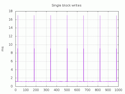

SD card read/writes are rather slow.
It depends a lot on your application. I went the low level route with no file system because I needed higher write speeds.
When writing data to an SD card you get best performance when writing in large, and I do mean large, blocks. (See SD specification.) There is a library around that sneaks up on this by starting the write of a large block and then leaving the SD card hanging between 512 byte blocks until it is done. Great if you are only writing large chunks of data and doing nothing else.
In the past when I have measured write speed I store the current value from a hardware timer into a 512 byte buffer and write that buffer. Then I can read the data and process the timer data to measure the time between 512 byte blocks. For example:
