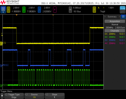

I ran your code from msg #1 without anything connected, just my oscilloscope. Here's the result.
At first glance, this looks like the SPI port is failing to transmit your 4 data bytes. But it does indeed transmit them correctly, the first time loop() runs. Then they are overwritten with whatever MISO receives, which happens to be zeros when I tested here. That's why the blue trace doesn't show your 4 data bytes.
But it I edit the code to always initialize the array with the data, indeed the data transmits every time.
