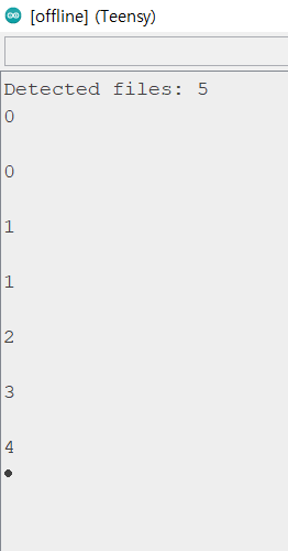

I am trying to get the names of all the files in an SD card and save them to an array. Originally, I planned to use vector, but then I found out that stl was removed in Arduino. So I wrote some code:

So this basically runs through all the files and saves the number of files. And then it makes an array using the saved value. And then it runs through all the files again and this time it saves them to the array. It's supposed to output the number of files and the file names but the actual output is this:
entry.name() returns a pointer to a C-style string - not to a String. Casting it will fix the problem:
fileList[i] = (String)entry.name();
Pete
Looking just at your "while" loop, you seem to be incrementing "i" too soon.
  while (i < fileNum) {
    File entry = file.openNextFile();
    Serial.println(i);
    if (!entry.isDirectory()) {
      fileList[i] = entry.name();
      i ++;      <== don't increment here - remove this line
    entry.close();
    Serial.println(fileList[i]);  <== if "i" is incremented earlier, then you are trying to print "the next" filename, instead of the filename just stored - maybe increment with "filelist[i++]" here instead
