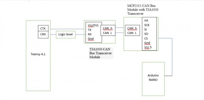

Hi, I am trying to achieve a CAN communication between a Teensy 4.1 and an arduino nano. For this,
I am using a TJA1050 transceiver connected to the Teensy 4.1 and a MCP2515 CAN controller
module connected to the arduino nano. I have successfully used CAN communication between two
arduino nano’s using two MCP2515 controllers, so I know that the mcp2515 is functioning correctly.
The problem lies in the Teensy-nano CAN communication. When I try to send data from the teensy
to the nano, it shows that data is being sent but stops after 17 iterations and none of this is received
by the nano.
I also tried setting the same bit rate but could not see anything being received on the Nano. If
anyone can help me out with this problem, it will be a great help.
Thank you.
My connections are as follows:
Code for Teensy 4.1
