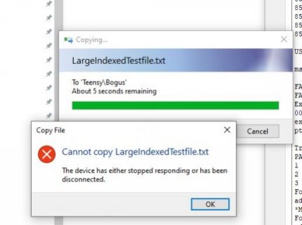

@Paul, @mjs313 @defragster - I have been testing mostly with our released version of LittleFS and see the issue, so as @mjs513 said it is unclear where the issues are. As I mentioned here or elsewhere, maybe not bad idea to update to more recent ones, especially if it maybe fixes some other things.
As for the issues of: partial file copy, and at times random reboot, or crash, trying to do some things that maybe try to isolate the problem(s), some which include:
a) Look again through the code to make sure I am not doing something stupid when we buffer the data.
b) I am hacking up a dummy FS, which does nothing that I can play with delays on writes and see if it shows up anything...
c) maybe take a break and do something else...
As we all know that some of these type problems are pain to isolate as maybe there is some simple off by one bug, which is maybe some code writes to wrong memory, but this does not hurt anything 99+% of the time... And only shows up in certain conditions. And this could be anywhere...
Now back to pulling out hair... :confused:

Right now writes just have a 5ms delay... And it copied almost all of the data for that 22mb file, and then the program reset:
Now back to ...
Most of the few runs I've done were posted ... but indeed some starts after an upload failed before the posted results.
Will get back to it soonish - and see what shows up with some different tests.
Is focus on MTP or MSC? Any proven best sketches to work with?
The good news is for me I have a 100% crash case... Now to debug...
I put the BogusFS.h as part of the USB_MTP-logger sketch...
I posted the sketch yesterday I was using to create the large USB Packet aligned serial numbers file...
I believe it is up in posting #421
As I showed up above it gets to the end and then crashes...
At least for this issue, it sort of rules out the file systems like littlefs and SD...
MSC stuff - Also good to test, but currently not doing much there until we decide if current path is the right one or if we need to migrate everything back to the MSC Github project.

I then tried sending a different smaller file to it and did not fault:
Modified: 6159df44
BogusFS::open(/FS.h, 2)
73410 RESP:2001(RSP:OK)l: 24 T:d : 20001 ffffffff 14
73410 CMD: 100d(SEND_OBJECT)l: 12 T:e
MTPD::SendObject: len:8732
BF Sequence error 0 0
BogusFS::open(/FS.h, 0)
 # USB Packets: 17 total: 0 avg ms: 0 max: 0
 # Write: 5 total:16 avg ms: 3 max: 4
>>>Total Time: 15490
73426 RESP:2001(RSP:OK)l: 12 T:e
It also showed my sequence number checking is being hit...
So what is left to try?
Maybe see about the code for update date/time... I don't think so as calls to bogusFS just return...
So again wondering if maybe hitting USB code issue? I am probably missing some other obvious thing, but...

Still not making much progress on figuring out where things are getting corrupted... When you boil it down, the send object of this one file more or less logically does:
Read in 43000 512 byte USB packets. It then stuffs more or less 4 of them at a time into an output buffer,
that we then do a write out to the destination file so about 10750 2k writes) Note: My bogus FS puts in 3ms delay per write, next try 2 and 1...
So far I have created a dummy FS, that more or less does nothing, so does not feel like that part is the issue. The copy of 4 reads into one buffer to do a write, I put in sandbox code to make sure that the memcpy calls do not extend outside of the buffer... So that sort of leaves us with the USB code...
The usb_mtp.c code is more or less an exact copy of the usb_rawhid.c (in cores/teensy4). Minor differences on it allows for the 512 byte transfers.
I simplified some of the code calling it, but the code simply calls:
usb_mtp_recv code with fixed buffer and timeout.
And again this code is more or less identical to rawhid: except it is possible that the size of buffer we allocate per transfer (512), may or may not be the same size we receive. Depends on which endpoint ... is connected (512 or 64)... Note: The MTP code does not check to see which one is actually connected...
Wondering now how to best test.
Note: I did test the code I put up last, on both Windows 10 and Ubuntu... both either rebooted or sometime incomplete transfers. Sometimes at the very end, sometimes not very far into the transfer.
Feels like some minor time window where things can get corrupted.

@mjs513 - is this the desired english from p#434? : completes with issue or hanging MTP
> expected to read 'without' ???
You are correct - T3.6 transfers complete without issues or hanging MTP.
In regards to the edit, that was just an observation and a comparison to similar issues that we saw before. Not necessarily the same issue.
Out of curiosity I modified that copSD2flash sketch to copy the indexBlockFile to the USB Drive as opposed to the flash drive. In this case no missed blocks were seen until the end when the last about 127K bytes failed to be written to the Jump Drive:
Note: the file on the left is the master file which has 42,999 blocks of index lines and the file on the left is from the jump drive after sketch completes
Seems to be real as the file on the jump drive is 20.8megs and the master file is 20.9megs. Since its really early for me not sure if I messed up the sketch:

As I am thinking there are some underlying USB issues and the usb_mtp code is based off of the usb_rawhid code.
Wondering if it is time to take a diversion and play with RawHid?
But I wonder does anyone know of some simple RAWHID code for a PC, that hopefully works on windows, with hopefully simple support within Visual Studio?
Or am I currently better off for now seeing if example code works on Ubuntu?
That is would like to see if we can replicate issue with existing released pieces... Note: AFAIK the current RawHid is limited to 64 bytes... Wonder how hard to extend to have
something like RAWHID512?
The test should be pretty simple: Try to send enough packets for something like 22mb of data... Have each record contain a sequence number and have simple sketch on Teensy that receives the packets and checks the sequence numbers, and see if it can run long enough without errors. And starting adding delays on receiving some/all of the packets and see if that makes a difference...
If this fails to reliably receive the data, then it probably shows that the some/all of the MTP problems are related...
Make Sense?

Was playing some more this morning with the USB/MTP and did a minor hack on send_object just to prevent the incomplete transfer messages and see what happens with the transfer.
Bottom line is that its loosing at 3 packets towards the beginning of the transfer (this time around it was within the first 1000 blocks of 512byte transfers). Think if maybe the 480 transfer on the usb host port is slowed a bit maybe we won't loose those missing packets.
Nothing else I tried seemed to make a difference - either got more missing packet or hung MTP.
So at this point just going to do some other testing for now.
