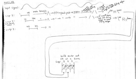

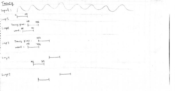

I am attempting to do real-time audio compression on a Teensy 4.0 with audio shield by doing triangular windowing, FFT, peak picking, IFFT, then overlap samples by 50% and add. I have an attempt here, but the output sounds bad, even picking all 128 peaks (no compression). Does anyone have experience or insight they can share? Thanks,
Gabe
//the reason there are 3 of everything is: in order to overlap the output blocks, 2 are needed to start with. it takes 2 to make an overlap. this is done in setup().
//after that, only 1 further block is needed at a time in order to overlap with the previous results. this is done in loop().

    //teensy audio works in q15 format. FFT works better in F32 format due to the dedicated FPU on the teensy. convert and store in inputbuffer
    arm_q15_to_float(&ptr_in1[0],&inputbuffer1[0],blockSize);
    arm_q15_to_float(&ptr_in2[0],&inputbuffer2[0],blockSize);
    //make triangles of input blocks 1 and 2
    for (int i=0; i<64; i++){
      trianglebuffer1[i] = inputbuffer1[i] *(i+1)/64;                       //index 0 = input * 1/64, index 63 = input * 64/64
      trianglebuffer1[128-(i+1)] = inputbuffer1[128-(i+1)] *(i+1)/64;       //index 127 = input * 1/64, index 64 = 64/64
      trianglebuffer2[i] = inputbuffer2[i] *(i+1)/64;
      trianglebuffer2[128-(i+1)] = inputbuffer2[128-(i+1)] *(i+1)/64;
    //do the FFT on the triangles and output to FFToutputbuffer.  Third argument 0 is for forward FFT, vs 1 for inverse FFT.
    arm_rfft_fast_f32(&FFT,&trianglebuffer1[0],FFToutputbuffer1,0);
    arm_rfft_fast_f32(&FFT,&trianglebuffer2[0],FFToutputbuffer2,0);
    //peak picking. set i<peaks, 128 for all peaks
    for (int i=0; i<128; i++){
      peakpickbuffer1[i] = FFToutputbuffer1[i];
      peakpickbuffer2[i] = FFToutputbuffer2[i];
    //Do IFFT on peaks picked.  Third argument 1 is for inverse FFT, vs 0 for forward FFT.
    arm_rfft_fast_f32(&FFT,peakpickbuffer1,IFFToutputbuffer1,1);
    arm_rfft_fast_f32(&FFT,peakpickbuffer2,IFFToutputbuffer2,1);
    //take each edge of each triangle to help follow wtf is going on
      rising1[i] = IFFToutputbuffer1[i];                                    //triangle1 rising edge
      falling1[i] = IFFToutputbuffer1[64+i];                                // triangle1 falling edge
      rising2[i] = IFFToutputbuffer2[i];                                    //triangle2 rising edge
      falling2[i] = IFFToutputbuffer2[64+i];                                //triangle2 falling edge
      overlapbuffer_f1r2[i] = falling1[i] + rising2[i];                     //falling1 plus rising2
      prev64_127[i] = overlapbuffer_f1r2[i];                                //prev64_127 will be used in loop(), since the first part of each output is the same as the last part of the previous output
      falling_prev[i] = falling2[i];                                        //falling_prev will be used in loop(), added to the current rising edge for the 64-127 samples of each output block
      outputbuffer[i] = rising1[i];                                         //first part of output block is triangle1 rising edge
      outputbuffer[64+i] = overlapbuffer_f1r2[i];                           //second part of output block is falling1 plus rising2
    arm_float_to_q15(&outputbuffer[0],&ptr_out[0],blockSize);               //convert from F32 back to Q15 for teensy audio output
    Q_1_play.playBuffer();                                                  //output first block to headphone jack
    Serial.println("Setup done");                                           //indicate success to serial monitor

  if(Q_1_rec.available()){                                            //check to see if there is a queue block available.
    ptr_in3 = Q_1_rec.readBuffer();                                   //copy addresses of 128 samples in queue block to ptr_in3
    ptr_out = Q_1_play.getBuffer();                                   //get pointer to output buffer "empty" array
    arm_q15_to_float(&ptr_in3[0],&inputbuffer3[0],blockSize);         //convert Q15 to F32
    //make triangle of input block
      trianglebuffer3[i] = inputbuffer3[i] *(i+1)/64;                 //index 0 = input * 1/64, index 63 = input * 64/64

Thanks for the replies you guys. Frank I see your point about the pointer pointing to a freed buffer. How silly of me! Mark I started to do two blocks, and got wrapped around the axle again.
I am starting to wonder just how real-time this can be. If frames are being overlapped, each one is essentially being shifted back to overlap with the previous one. While this is happening, the input data just keeps coming. So it seems like a delay will arise and get worse over time.
I have a non-real-time matlab program that just does simple compression on a 3 second .wav file. When I made a crude chart of how the matlab program works, and then tried to make a matching chart for the teensy, there seemed to be this important difference where the input data is streaming in but the compression just keeps getting farther behind the teensy due to the overlapping. Because the teensy is going to give blocks of 128 constantly no matter what, and it has to, if it is to be real time.
There are other minor differences such as matlab being 256 and teensy being 128, and starting indexes of 1 and 0 respectively, but that wouldn't seem to change things much.
Does anyone know of this being done before?
Thanks,
Gabe
MATLAB code:
clear all; close all; clc;
num_peaks = 129; % the number of peaks to pick
info = audioinfo('cleanspeech.wav'); % get number of samples in input wav
Length = info.TotalSamples; % store number of samples in Length
s_hat = zeros(Length,1); % prepare output vector of zeros, the same length as input
s_A_rising = zeros(128,1); % prepare the vector of zeros to capture the rising edge of every other triangular frame A
s_A_falling = zeros(128,1); % prepare the vector of zeros to capture the falling edge of every other triangular frame A
s_B_rising = zeros(128,1); % prepare the vector of zeros to capture the rising edge of every other triangular frame B
s_B_falling = zeros(128,1); % prepare the vector of zeros to capture the falling edge of every other triangular frame B
s_C = zeros(128,1); % prepare the vector of zeros to add the rising edge of the next to the falling edge of the prev and vice versa
%filename = 'output1.wav'; % name of the output file, if needed
rows = 2; % number of rows in the plot
columns = 3; % number of columns in the plot
%Find the peaks, zero out the rest, then put its ifft into s_hat
n = (2 * Length / 256) - 1; % determine number of iterations needed to process entire input
%with traingular overlapping frames of 256 samples each. overall twice as many frames as
%non-overlapping rectangular minus 1
for i = 0:n-1 % number of iterations beginning at zero
    c = 128 * i; % setup for moving window of frames. 1st frame is 1-256, 2nd is 129-384, etc.
    a = 1 + c; % starting index of current frame
    b = 256 + c; % ending index of current frame
    bb = 128 + c; % ending index of rising/falling edge addition
    [s, fs] = audioread('cleanspeech.wav',[a b]); % read current frame of 256 samples. fs is intrinsic to .wav
    % make triangular frame by multipling sample n = 1 thru 128 by (n /
    % 128).  The second loop is the downward slope.
        %upward slope
        for m = 1:128
            s(m) = s(m) * m/128;
        end
        %downward slope
        for m = 1:128
            s(257-m) = s(257-m) * m/128;
        end
    S = fft(s); % take Fourier Transform of current frame
    mags = zeros(num_peaks,1); % mags is a vector of zeros, of the number of picked peaks
    %Find the highest magnitudes and put them in to mags
    mags = maxk(S,num_peaks);
    mags = abs(mags);
    %Zero out all parts of S that with magnitudes less than mags
    for iii = 1:256 % 256 iterations, one for each element in the current frame
        if abs(S(iii)) < mags(end) % if absolute value of S(iii) is less than the last, smallest, element in mags, replace with 0
            S(iii) = 0;
        end
    end
    s = ifft(S); %take inverse FFT of S and store in s
    IS_EVEN = ~mod(i,2); %setup for every other iteration to store and add the triangle edges
    if IS_EVEN == 1; %first and every other iteration use the rising edge of current triangle added to falling edge of prev
      s_A_rising = s(1:128,1); %rising edge of this triangle
      s_A_falling = s(129:256,1); %falling edge of this triangle
      s_C = s_A_rising + s_B_falling; %add this rising edge to previous falling edge and store in 128 element s_C
    else     %second and every other iteration add the falling edge of the last triangle to the rising edge of the current
      s_B_rising = s(1:128,1); %rising edge of this triangle
      s_B_falling = s(129:256,1); %falling edge of this triangle
      s_C = s_A_falling + s_B_rising; %add last rising edge to current falling edge
    end
    s_hat(a:bb,1) = s_C; %build output vector s_hat 128 elements at a time (edges added together)
end
No, the latency is a fixed number of blocks, this is just like a pipeline.
