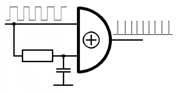

    Maybe an XOR gate is good enough?
    Sorry, no article in English. With tuning RC you can adjust the width of the impulses.
    https://de.wikipedia.org/wiki/Freque...g_(Elektronik)
