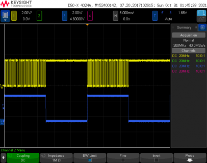

Here is a simple program to test CTS by connecting one of the PWM pins to the CTS pin.
elapsedMillis timeout;
int count;
  Serial1.begin(9600);
  Serial1.attachCts(30); // connect pins 2 & 30
  analogWriteFrequency(2, 40);
  analogWrite(2, 128);
  timeout = 0;
  count = 0;
  Serial1.write(0x5A);
  count++;
  if (timeout > 1000) {
    timeout -= 1000;
    Serial.print(count);
    Serial.println("  bytes per second");
    count = 0;
When I run this on a Teensy 4.1 with a wire connecting pins 2 and 30, these are the waveforms I see.
I also see this printed in the serial monitor window, indicating half of the possible 960 bytes each second are actually transmitting.
480  bytes per second

Viewing TX3 (pin 14) instead of TX1, I see the same waveforms on my scope, and again it's printing 480 bytes per second.
I don't know why it's not working for communicating with that ESP board, but from this simple test it looks like CTS on pin 30 does indeed work, for both Serial1 and Serail3.
Thanks for your prompt replies!
I tested a while with your code. I think I found a wrong behavior of CTS: when I use the hardware CTS pin (19 for Serial3), it transmits when CTS is LOW, but when I use the XBAR CTS pin (30), it transmits when CTS is HIGH.
So, for the (second) test code using PWM, the transmission count is the same for both 19 and 30, and thus it looked like working... but it isn't indeed. If I connect both 19 and 30 to 2 and change analogWrite to "analogWrite(2, 16)", and if run your code with "Serial3.attachCts(30)", I get 80 bytes per second. But when I run the code with "Serial3.attachCts(19)", I get 920 bytes per seconds.
I don't understand how XBAR works yet, but as a very vague guess, perhaps what the IMXRT manual calls "AOI" might do something we don't want...
Yikes, yes, you're right. The polarity is backwards! That's definitely a bug in Teensy 4 hardware serial when CTS is connected by XBAR.
