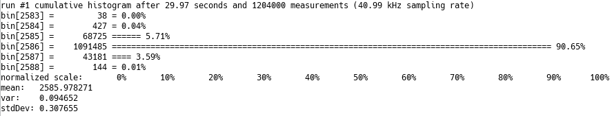

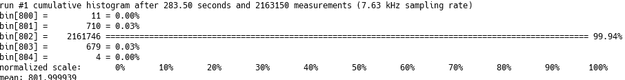

I was curious to see how accurate the 12-bit ADC is on the Teensy 4.x. The pjrc product page suggests there is some limitation ("The hardware allows up to 12 bits of resolution, but in practice only up to 10 bits are normally usable due to noise") but I wanted to see if more refinement was possible by repeated samples and averaging, and how the noise distribution looked.

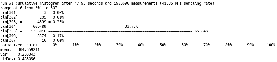

So I wrote a simple program to print out the histogram of measurements. Here is an example measuring a 5k pot at some position between 3.3v and ground, using analogReadBitDepth=12 and analogReadAveragingNum=32:
And here is an animation of the first 15 seconds:
The accuracy of the mean seems to improve after time. (I might want to investigate more to see how quickly it converges to a specified degree of accuracy.) The noise looks roughly like it could be gaussian on first glance.

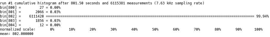

Turns out the analogRead function has a limited sampling rate...cause it seems at 12-bits I was only able to sample at 6.41 kHz (regardless of the value I used for analogReadAveragingNum). I don't know if using the advance ADC library or trying to handcode something will improve it, or if there is some hardware limit with this (( did peek at the teensy core github repo and see the function waits for some condition before making another reading). With analogReadBitDepth=10 I got 7.63 kHz sampling rate:

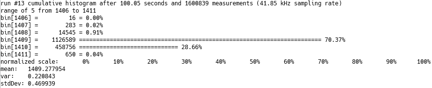

and after even more time:
As expected considering the note that "in practice only up to 10 bits are normally usable due to noise", turns out there is much less variation, though there still are some deviations probably also due to noise. With 8 bits only, the results are almost always exactly on one value or another without only the occasional variation:

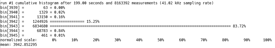

aha, well I found there's settings for Conversion speed and Sampling speed in the ADC library, and running the example "conversionSpeed" from it, I found that in Continuous mode can get can get at best .53 us on 8-bit, .64 on 10-bit, and .75 us on 12-bit. And in Single-shot mode best can get is .99 us on 8-bit, 1.12 us on 10-bit, and 1.19 us on 12-bit. I've sorted the output of that example on my teensy 4 by speed:
https://docs.google.com/spreadsheets/d/1AVG81a3CWeJ2VWcEFinKArPHD07hX6ibjdECMzZMeT4/edit?usp=sharing
So now I need to update my program tot use these conversion speed settings.
variance or standard deviation at this highest sampling & conversion rate at 12 bits seems to range from .32 to .56 depending on position of my 5k pot (probably the internal sampling capacitor charges differently based on the impedance...ideally I should be measuring from the output of a low impedance source like an opamp).
And I guess a lot of the variance depends on whether my pot happens to be positioned such that the mean hits right on a integer, or whether the mean falls in the middle of two integers (in which case the variance calculation is results in a much higher values, cause it looks like a bimodal distribution).
8-bits: 58.59 kHz max sampling rate
10-bits: 48.83 kHz max sampling rate
12-bits: 41.85 max sampling rate
That is using ADC_CONVERSION_SPEED::VERY_HIGH_SPEED and ADC_SAMPLING_SPEED::VERY_HIGH_SPEED on my Teensy 4.0. I guess that must be hitting some internal hardware limitation. Unless there is something I'm missing someone can clue me in.

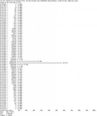

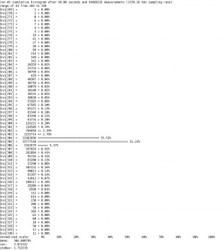

it is worth pointing out that my earlier measurements were using averaging=32. If I only use averaging=1, then there is a much larger spread in the measurments, though can get up to 1.34 MHz sampling rate:

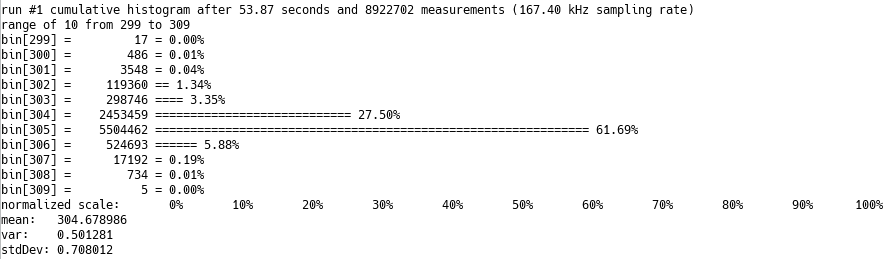

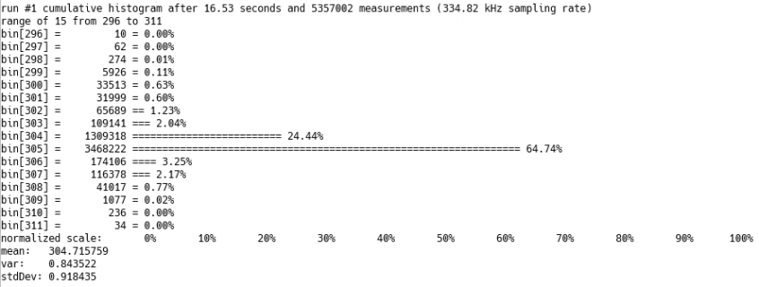

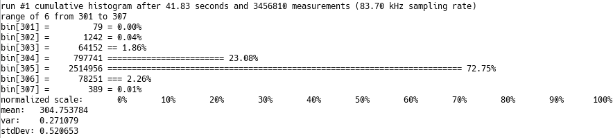

Comparison of frequencies & noisiness of measurements when going from averaging=32 to averaging=1 for 12-bit at highest speed:
averaging 32: 41.85 kHz, stdDev = 0.483
averaging 16: 83.70 kHz, stdDev = 0.521
averaging 8: 167.40 kHz, stdDev = 0.708
averaging 4: 334.82 kHz, stdDev = 0.918
averaging 1: 1339.25 kHz, stdDev = 1.75
I'm glad I did this, cause now I have a much better idea about how precise the measurements relative to the averaging rate. I guess depending on your desired usage you will pick a different averaging rate based on tolerable standard deviation...as there is a clear inverse relationship between precision and nAveraging.

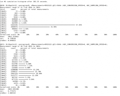

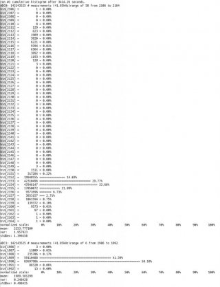

I updated my code to use both of the hardware ADC0's on the teensy 4: https://github.com/ericfont/teensy_...c65e0f2b9602/teensy_histogram_measure_ADC.ino
I just tested with ADC0 connected to the middle of a 1 megaohm pot and ADC1 connected to the middle of that earlier 5 kohm pot, and ran the histogram for 50 minutes, and here is the result:
First note that the 1Mohm on ADC0 has a lot more variance in the measurements than the 5 kohm on ADC1. This is as expected from theory because internally the pots have to charge a capacitor for measuring, and that charging time has a component of delay proportional to that RC delay. I did notice some interesting quick that the 1 mohm measurment histogram has something of a smaller normally distributed mode (here centered around bin[2116]) with about .01% of the measurements hit (and a few more hundreths of a percent hit around that). That is very curious...probably some odd thing happening with the charging of the measurement capacitor or the voltage supply levels. Meanwhile the 5k pot measurementts are much more tight. So I think the lesson (as expected from theory) is to use low impedance input lines going into the ADC measurement pin (for example from the output of a omp amp).

I'm investigating how having each ADC on different configuration affects the precision... Something interesting is that it always seems that ADC0 is much more accurate than ADC1 regardless of the settings. I am in "continuous mode"...so I'm wondering if maybe it is a bad idea to use both ADCs in continuous mode....or maybe if use both then use ADC0 for data that needs precision and leave ADC1 for data that you aren't worried about precision nearly as much. For instance, here is BitDepht=12, averaging=8, @23.4Khz, both sampling and conversion at low speed):
And that spread on ADC1 is way higher than one. both are measuring the middle of their own separate 2kohm voltage divider between 3.3v and gnd.
Something interesting is that it always seems that ADC0 is much more accurate than ADC1 regardless of the settings...

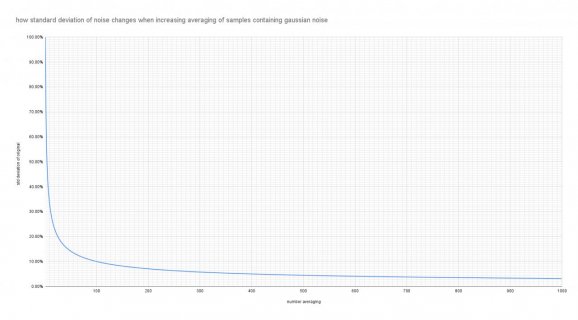

Useful rule of thumb: if the distribution is Gaussian, the standard deviation of the average is proportional to 1/sqrt(N) where N is the number of points averaged.
Unfortunately that square root has consequences. To get ten times the precision (i.e. one more digit after the decimal point), you have to average 100 times as many data points.
ahh...thanks for the insight. So I guess plugging that equation in...with averaging of 32 I guess can theoretically expect noise to be only about 17.7% of original.
for my personal reference I made a spreadsheet of the theory: https://docs.google.com/spreadsheets/d/1gxDhfphANvj7ONVUtJC7trOOcw9ze7UgZbRN2VchckU/edit?usp=sharing
And made a chart from that:
how standard deviation of noise changes when increasing averaging of samples containing gaussian.jpg
https://docs.google.com/spreadsheet...vDL/pubchart?oid=166100424&format=interactive
I guess the take-away is that the benefit from averaging is much larger when starting to do averaging, but has significantly diminishing marginal returns... Gets to 30% of original with just ~12 samples, then 20% of original with just ~28 samples, but then gets to %10 of original with 100 samples, then 5% of original with 500 samples, and then asymptotically approach 0.
