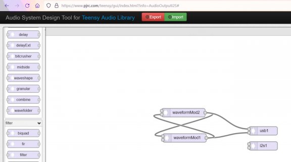

Hi there,
I'd like to understand how block processing happens at a high level when the audio "graph" contains loops, as in the case below (waveform2 gets fm from waveform1, waveform1 gets pwm from waveform2). Given that the Audio library processes AUDIO_BLOCK_SAMPLES at a time, I see the following options:
  1. always use data that lags by AUDIO_BLOCK_SAMPLES (each waveform uses the "cached" result of the previous block processing)
  2. arbitrarily (or otherwise by some set of rules), break the cycle and process (say) waveform1 then use the result for waveform2
  3. something else?
If it's 2. are there some rules I might understand?
#include <SerialFlash.h>
AudioSynthWaveformModulated waveformMod2;   //xy=491.20001220703125,327
AudioSynthWaveformModulated waveformMod1;   //xy=495.20001220703125,416
AudioOutputUSB           usb1;           //xy=772.2000122070312,391
AudioOutputI2S           i2s1;           //xy=772.2000122070312,444
AudioConnection          patchCord1(waveformMod2, 0, waveformMod1, 0);
AudioConnection          patchCord2(waveformMod2, 0, usb1, 0);
AudioConnection          patchCord3(waveformMod1, 0, usb1, 1);
AudioConnection          patchCord4(waveformMod1, 0, waveformMod2, 1);

Its extremely simple, the audio objects are run in the order they are declared, once each. No dependency analysis is currently done so that if
you declare a destination before its source, that object gets the block from the last run (typically that's a 2.9ms latency hit). If you
have a linear dataflow and declare the objects in that same order, no unnecessary latency happens. You always have to have at least one
block of latency for any cycle of course.

Thanks both, very much appreciated. So to confirm, in the following example,
AudioConnection          patchCord2(waveformMod2, 0, waveformMod3, 0);
patchCord1 is declared first, and so the processing order is: waveformMod2 then waveformMod1, then waveformMod3 (as waveformMod2 has already been processed) - waveformMod1 and waveformMod3 will both use the block from waveformMod2 that was just processed?

For other people coming to this thread later, I just wanted to be clear...no, the code above is not what sets the order that the calculations are performed. What sets the order ( per post #2 and the revised #3) is the order that the audio classes are instantiated (created), not the AudioConnections.
The instantiation of the audio classes is not shown in the snippet above, but they're presumably created as: waveformMod1, waveformMod2, and then waveformMod3. This will also be the order in which they will be updated. Because waveformMod1 is getting called before the data from waveformMod2 is ready, waveformMod1 will end up using audio data from the previous cycle. Hence, this introduces an extra latency in the overall processing. Usually, this isn't a big deal for most uses.
