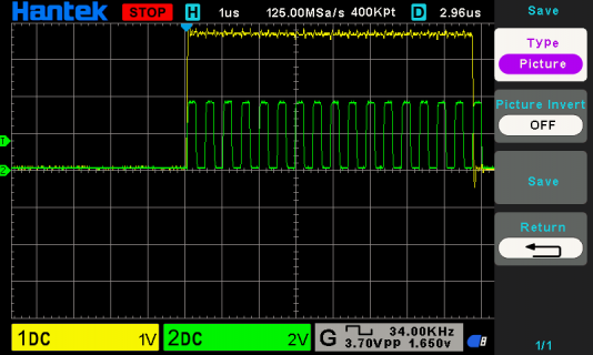

I've gotten the SPI to work at the correct clock and all other critical parameters, however I have ran into a slight problem. While I was figuring out how to communicate with the YM3014 using CPU-driven bit-banging I noticed something. This chip absolutely requires one more clock pulse after LOAD goes low (end of frame) to convert the signal. By looking into the datasheet, I've figured out that this is due to the LOAD signal being delayed internally within the chip and because of that it needs that just one more clock pulse. Is it possible to send that one more clock pulse after LOAD goes low or is that something that SPI simply cannot do?
Here is what I mean, this is what we currently have. The yellow signal is LOAD, the green one is CLOCK. Notice how when LOAD goes low, the clock also stops sending any pulses.

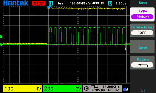

And here is what we need, notice that one extra clock pulse after LOAD has already gone low.
If generating the extra clock pulse is not possible then maybe, could I attach an external clock to both the teensy and the YM3014? This way the clock would always be running and the YM3014 would be happy and the teensy could just synchronize it's LOAD and MOSI signals with this external clock. I'm doubtful you can do that as SPI has a master driven clock but hey, worth asking right?
