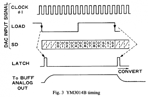

With some fiddling and watching the waveforms on a scope or logic analyzer, you'll probably find a way to get the LRCLK to be high for 8 cycles and low for 8 cycles. Maybe configure FRSZ for only 1 word per frame, and SYWD for 8 bits so LRCLK gives you the "LOAD" signal that chip wants.
My understanding is "LATCH" on this diagram is a signal internal to the chip, so once you get the frame size down to just one 16 bit word and the correct size / polarity / offset sync pulse, you should have everything you need.
Thank You, I'll try it out. I've already setup the communication to have the correct number of bits per LR pulse, but I'll try to play some more with the I2S parameters. Though I can see that I may have made a few mistakes in my setup so hopefully I'll be able to get this working. Thank You very much for the help. As for, why don't I get a better chip? Well, I'm using it mostly to figure out how to utilize I2S to do things it wasn't meant to do. Same goes for my earlier SPI attempts. I’ve seen Bitluni utilize weird hardware modules on the ESP32 to control things like this and I always wanted to try that. Plus, I have many other “more practical” ICs with similar communication protocols to that of the YM3014, so it was wise I think to get some practice with doing things like this on a simpler chip. Plus, I have a lot of these chips so maybe they'll come in handy one day.

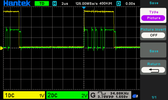

Hello,
I'm just posting to let people know that all is working now. I have configured the communication to occur just like my bit-banging tests with a single 16-bit word, and a active high SYNC pulse during transmission. I have kept the RX module to generate the Bit Clock, as the TX's pins are unavailable on the Teensy 4.0. However, I have utilized the TX module to send the SYNC pulses so I can use it's ONDEM mode. This way I'm only transmitting samples when there is something to send, fulfilling my requirement for the data latching. And here are the results:
Yellow -> TX Sync Pulse
Green -> Sound data (16 bits)

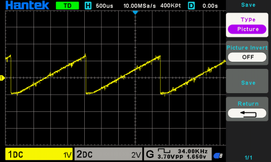

And the YM3014's output, a nice saw wave. The noise is due to this being on a breadboard.
Once, again thank You very much for all the help.
