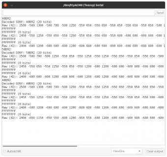

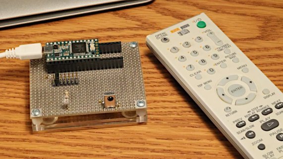

I ran a quick test here, since it's been a long time since I've tested IRremote. TL;DR = works fine on Teensy 3.2.
First, I pulled out the board I soldered so many years ago for IRremote testing. It has a IR LED with jumpers to connect to various pins, and a IR receiver module with its output connected to pin 6.
I tested with Arduino 1.8.16 and Teensyduino 1.56-beta3 (the latest beta, though 1.55 and other versions should be the same... IRremote hasn't changed lately). Just to be clear, this is the copy of IRremote which Teensyduino installs. I clicked File > Examples > IRremote > IRrecvDump. The only change I made was to edit the pin number, since this board has the hardware on pin 6.

Then I uploaded it to Teensy 3.2 and opened the serial monitor. When I press buttons on that remote control, this is what I see on my screen.
IRremote really does "just work" on Teensy 3.2 if you use the latest software (or probably any version from the last several years) and just run the examples from the IRremote library Teensyduino installed.
If you have a bunch of stuff you've installed, pay close attention to messages Arduino prints about duplicate libraries. The known good copies from Teensyduino are in {Arduino}/hardware/teensy/avr/libraries. If you install the same library in {Documents}/Arduino/libraries, it will override the known-good copy from Teensyduino. Those duplicate library messages are meant to help you see which version you're really using. Maybe use File > Preferences to turn on verbose output during compilation to make sure you get those messages (otherwise they might only show up when you have a compiler error).
Just use the known good copy Teensyduino installs and this stuff just works.
