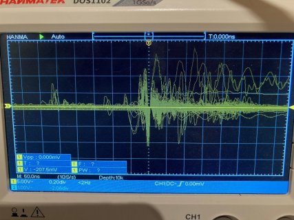

So I *may* have a handle on my T3.5-killing problem. After performing the above 'near but not connected' experiment, I followed it with one where the T3.5 was mounted on the robot chassis, but not connected to anything. As expected no problem after repeated charging power connect/disconnect cycles. The next experiment was to connect T3.5 GND to robot GND only - nothing else connected, with power to T3.5 supplied via USB. No problems after repeated charging power connect/disconnect cycles.
Since I now had a common ground reference for the T3.5 and the robot, I was able to look at the waveform at the output of the connect/disconnect resistive voltage divider (see the above schematic). I ran a long series of connect/disconnect cycles using my Hanmatek DOS1102. I observed some very substantial ringing on this line, clearly enough to damage the input, as shown below.

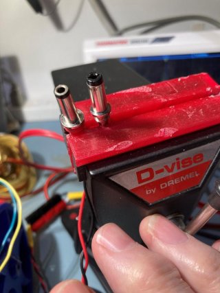

On the above trace, the vertical scale is 5v/div, and some of the excursions are close to +/- 20V! After doing some more experimentation, I began to realize that what was happening was the center (positive) contact of the particular 2.1mm plug I was using (left-hand plug in the above photo) was intermittently coming into contact with the grounded shell of the plug, causing a momentary short across the power supply output, which was making the positive supply line, and everything connected to it, to ring badly.
I've been using this connector for years with no problems, but the power supply shorting issue never arose because I had a non-conductive docking collar around the charging port and I now think that prevented the center contact from touching the grounded shell of the plug.
I performed a number of connect/disconnect cycles with my lab power supply using the right-hand plug style with a non-conducting tip, and this exhibited no ringing issues at all.
I'm not completely satisfied yet, but I think I might have the smoking gun now. We'll see.

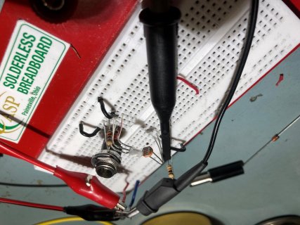

I believe I have now completely solved this issue, by using a LED/photoresistor pair to break the conductive path from the charging circuit to the Teensy. The LED part of the pair is the 2-color LED supplied with most TP5100 modules, installed onto the designed-in PCB pads on that module. The GL5537 photoresistor part of the pair is installed nose-to-nose with the LED to produce basically singe-digit resistances when the LED is illuminated. I tested this on a breadboard setup using a 20K pullup to 3.3V, simulating a Teensy GPIO set for pinMode(PIN, INPUT_PULLUP), as shown below:
See this post on my blog site for all the gory details.
