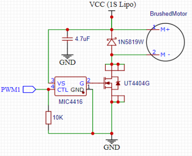

Hello there,
I use the Teensy 4.0 to control a brushed motor (8.5x20) with a PWM signal (20khz).
I created a PCB for this. It works, but the motor and the mosfet get very hot quickly. I use a 1S Lipo Battery.
Even at 1A it gets hot. If, on the other hand, I connect the motor directly to a voltage supply, it only gets slightly warm.
So it must have something to do with the circuit. The Mosfet should not get warm with such a small load.
The motor driver is actually designed for 4.5V, not 3.7V. Nevertheless, I still use it because you can see in the data sheet that it
should output around 100mA even at such a low voltage. This is sufficient as a gate current for the Mosfet at that frequency. Even 50mA should be fine.

This is the schematic:

I don't understand. You mention a PID loop yet I don't see any possibility of running the motor in reverse direction in the schematic.

A typ PID loop will cause + and - deviations, especially if you want fast response and use a high pwm freq. Regardless, the MIC4416 spec for VS is 4.5 minimum. There is nothing that indicates otherwise. A blown fuse on your current meter seems the likely result. Try the spec. minimum V and maybe it will work. Not sure the driver is even necessary with an appropriate FET.

My bet would be the driver. You are formally operating the chip outside its voltage supply range and thus:
†† Notice: The device is not guaranteed to function outside its operating ratings.
Nevertheless, I still use it because you can see in the data sheet that it should output around 100mA even at such a low voltage.
Did you read that from figure 2-22? I wouldn't draw that conclusion...

If the driver isn't driving the FET gate with nice fast edges due to the too low power supply voltage, I can imagine that the FET gets warm.
Paul
Assuming the output from the driver is too small or smaller than I assumed, could that lead to the heat? Maybe because the MOSFET will never turn completely on and off?
I'd be very interested in that.
Yes, that could lead to the heat. A FET stays only cool if you switch the gate fast - hence the use of a driver to take care of that gate current. Simply said, a FET gate is a capacitor that you need to charge and discharge quickly.
