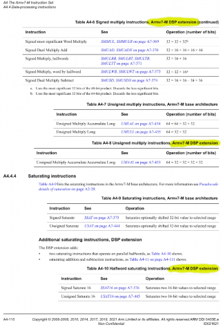

Here is the ARM v7M reference manual.
https://www.pjrc.com/teensy/DDI0403Ee_arm_v7m_ref_manual.pdf
To be precise, the specific instructions are described as "Armv7-M DSP extension" in this manual. For example, on page 110:
Also, these instructions work on M3 CPUs too, which also had me confused as I expected the ARM M4 to have some special DSP features that the M3 CPU is missing in its DSP stuff.
No, the "Armv7-M DSP extension" instructions do not work on Cortex-M3.
So, my question is, how can I perform addition and subtraction on top or bottom half-words, as well as many other operations?
You can do addition and subtraction, but only in limited ways. See section A4.4.7 on page 112 for details.
And in general, all questions about what you can and can not do with ARM Cortex M3, M4, M7 instructions are precisely (but perhaps tersely) answered by this reference manual.
