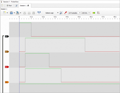

Difficult to help if you don't post complete code showing the issue. I tried to deduce from the fragments what you want to achieve. Looks like the run function is supposed to be non blocking and should switch the pump on for n seconds. Here an example showing how to implement this with the TimerTool.
Remarks and assumptions:
  • If I deduced the required functionality correctly you need a OneShotTimer rather than a PeriodicTimer. I changed that accordingly.
  • I assume the required timings might be quite long so I used the TCK64 timers. You have 20 of them and they run up to several hundred years with the full 1.66ns resolution.
  • Since the TCK timers are software based you don't need to make the variables volatile.
  • You didn't include your Pinout class -> I hardcoded the pins.

PumpClass Pump0(0, 0), Pump1(1, 1), Pump2(2, 2), Pump3(3, 3);
    pinMode(LED_BUILTIN, OUTPUT);
    Pump0.run(1);
    Pump1.run(5);
    Pump2.run(2);
    Pump3.run(3);
    digitalToggleFast(LED_BUILTIN);
    delay(150);
The code produces this on the 4 pump pins
@luni yeah you're right, thought it would be enought code sorry:D
