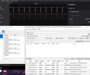

@PaulStoffregen and @mick
I picked up 4 more of the HiLetgo pwm servo drivers (knock offs of the adaftruit) so now I have a total of 5 of the drivers attached to the T4.1.
Running I2CScanner:
Scanning...
Device found at address 0x40  (PCA9685,Si7021)
Device found at address 0x41  (STMPE610,PCA9685)
Device found at address 0x42  (PCA9685)
Device found at address 0x43  (PCA9685)
Device found at address 0x44  (PCA9685)
Device found at address 0x70  (AdafruitLED)
done

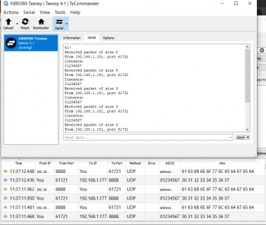

and running the sketch in post #2 again
ATTACH=CONFIG]29300[/ATTACH]
I am getting the blinking LED and am able to receive packets and get the acknowledge packet back.
So not sure what you mean by stop responding?
EDIT: I did just turn debug on in the adafruit library and didn't see where setPWM was failing or stopping?

Thanks. Was waiting on some additional info but not sure where to go from here. Still thinking about hooking up a servo to board #5 or hook up a LA just to if the signals are good. Any other ideas would be apprecated
@PaulStoffregen
Ok out of curiosity attached the LA to the I2C lines on the T4 to see if it stopped working while sending packets - short answer looked like on the LA I2C stayed operational

Just out of curiosity and as a final test case I attached a servo to 0x40 and 0x41 and ran the test case which is set up just to test the servo on board 0x40. The servo continued to rotate even with me sending UDP packets from the PC to the T4.1.
#include <NativeEthernet.h>
#include <NativeEthernetUdp.h>
// Enter a MAC address and IP address for your controller below.
// The IP address will be dependent on your local network:
byte mac[] = {
  0xDE, 0xAD, 0xBE, 0xEF, 0xFE, 0xED
IPAddress ip(192, 168, 1, 177);
unsigned int localPort = 8888;      // local port to listen on
// buffers for receiving and sending data
char packetBuffer[UDP_TX_PACKET_MAX_SIZE];  // buffer to hold incoming packet,
char ReplyBuffer[] = "acknowledged";        // a string to send back
// An EthernetUDP instance to let us send and receive packets over UDP
EthernetUDP Udp;
// constants won't change. Used here to set a pin number:
const int ledPin =  LED_BUILTIN;// the number of the LED pin
// Variables will change:
int ledState = LOW;             // ledState used to set the LED
// Generally, you should use "unsigned long" for variables that hold time
// The value will quickly become too large for an int to store
unsigned long previousMillis = 0;        // will store last time LED was updated
// constants won't change:
const long interval = 1000;           // interval at which to blink (milliseconds)
#include <Adafruit_PWMServoDriver.h>
#define PWM_NUM 5
Adafruit_PWMServoDriver pwm[] = { (0x40), {0x41},(0x42), {0x43}, (0x44)  };
// Depending on your servo make, the pulse width min and max may vary, you
// want these to be as small/large as possible without hitting the hard stop
// for max range. You'll have to tweak them as necessary to match the servos you
// have!
#define SERVOMIN  150 // This is the 'minimum' pulse length count (out of 4096)
#define SERVOMAX  600 // This is the 'maximum' pulse length count (out of 4096)
#define USMIN  600 // This is the rounded 'minimum' microsecond length based on the minimum pulse of 150
#define USMAX  2400 // This is the rounded 'maximum' microsecond length based on the maximum pulse of 600
#define SERVO_FREQ 50 // Analog servos run at ~50 Hz updates
// our servo # counter
uint8_t servonum = 0;
  pinMode(ledPin, OUTPUT);
  for (uint8_t p = 0; p < PWM_NUM; p++) {
    pwm[p].begin();
    pwm[p].setOscillatorFrequency(27000000);
    pwm[p].setPWMFreq(SERVO_FREQ);  // This is the maximum PWM frequency
  Wire.setClock(400000);
  // start the Ethernet
  Ethernet.begin(mac, ip);
  while (!Serial) {
    ; // wait for serial port to connect. Needed for native USB port only
  Serial.println("hi!");
  // Check for Ethernet hardware present
  if (Ethernet.hardwareStatus() == EthernetNoHardware) {
    Serial.println("Ethernet shield was not found.  Sorry, can't run without hardware. :(");
    while (true) {
      delay(1); // do nothing, no point running without Ethernet hardware
  if (Ethernet.linkStatus() == LinkOFF) {
    Serial.println("Ethernet cable is not connected.");
  // start UDP
  Udp.begin(localPort);
  float b = map(sin(millis() * 0.01), -1, 1, 0, 1);
  int t = b * 4095;
 // Drive each servo one at a time using setPWM()
  Serial.println(servonum);
  for (uint16_t pulselen = SERVOMIN; pulselen < SERVOMAX; pulselen++) {
    pwm[0].setPWM(servonum, 0, pulselen);
  for (uint16_t pulselen = SERVOMAX; pulselen > SERVOMIN; pulselen--) {
  // Drive each servo one at a time using writeMicroseconds(), it's not precise due to calculation rounding!
  // The writeMicroseconds() function is used to mimic the Arduino Servo library writeMicroseconds() behavior.
  for (uint16_t microsec = USMIN; microsec < USMAX; microsec++) {
    pwm[0].writeMicroseconds(servonum, microsec);
  for (uint16_t microsec = USMAX; microsec > USMIN; microsec--) {
  servonum++;
  if (servonum > 2) servonum = 0; // Testing the first 8 servo channels
  // if there's data available, read a packet
  int packetSize = Udp.parsePacket();
  if (packetSize) {
    Serial.print("Received packet of size ");
    Serial.println(packetSize);
    Serial.print("From ");
    IPAddress remote = Udp.remoteIP();
    for (int i=0; i < 4; i++) {
      Serial.print(remote[i], DEC);
      if (i < 3) {
        Serial.print(".");
    Serial.print(", port ");
    Serial.println(Udp.remotePort());
    // read the packet into packetBufffer
    Udp.read(packetBuffer, UDP_TX_PACKET_MAX_SIZE);
    Serial.println("Contents:");
    Serial.println(packetBuffer);
    // send a reply to the IP address and port that sent us the packet we received
    Udp.beginPacket(Udp.remoteIP(), Udp.remotePort());
    Udp.write(ReplyBuffer);
    Udp.endPacket();
  //delay(10);
  unsigned long currentMillis = millis();
  if (currentMillis - previousMillis >= interval) {
    // save the last time you blinked the LED
    previousMillis = currentMillis;
    // if the LED is off turn it on and vice-versa:
    if (ledState == LOW) {
      ledState = HIGH;
      ledState = LOW;
    // set the LED with the ledState of the variable:
    digitalWrite(ledPin, ledState);
