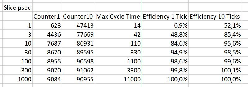

From the Doku it was not really obvious to me, how to set up different priorities and how to set up the right slice time. So I did some experiments with the code below.
This sets the timeslice for one tick to 10 microseconds.
In this case this is 10 * ticks = 100µs per cycle for the second thread.
In my application, I wanted some time critical audio data handling outside the audio library to run with very high priority and have the graphical user interface with ST7735_t3 run with rather low priority. The audio library is running controlled by its own interrupt.
If you have 5 threads running, one of them the normal Arduino loop, then their number of ticks add up to a cycle time together with time for interrupt driven code. Only after this cycle time a specific thread will run again. So you are interested to have a low time slice for a tick. On the other hand switching of threads needs time too, so very low time slices have low efficiency.
The test is using two counters and the count after 1 second is compared for different tick lengths.
The picture shows efficiency for a Teensy 4.1 running at 600MHz. There are two counter threads running as loops without thread.yield(). The first with one tick and the second with 10 ticks priority. If you choose a tick length of 10 microseconds, it still gives an efficiency of 95% for the second high priority thread and 85% for the low priority thread.
The table shows the count numbers in thousands (in 10-fold time you should get 10-fold count) and it shows the maximum cycle time. So for a tick length of 10 microseconds with one thread of 1 tick and one thread of 10 ticks you get a cycle time of 110 us. In this case, the time for interrupt driven code is neglectable.
So all-in-all for Teensy 4.1 @600MHz a tick length around 10 microsecs seems to be something like a sweet spot for still rather good efficiency and low cycle time.
threads.setSliceMicros(10); // Setting is needed!
int id1= threads.addThread(thread_func, 1); // Start first function with parameter 1
int id2= threads.addThread(thread_func2, 1); // Start second function with parameter 1
threads.setTimeSlice(id2, 10); // set priority. This Thread gets 10 times more time
