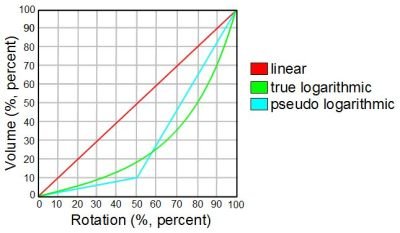

There's also the possibility of "pseudo-log" (borrowing a term from the analog world) where the curve is simplified to a couple of straight lines that approximate said curve. This is what log potentiometers do to ease manufacturing. Like this:

Thanks. I ended up playing the function this author described for a bit while learning to use log and Exp type functions. There were pros and cons. In the end, they gave a lot of precision but I wasn't able to figure out to to scale my input data off of the curves. For example getting a log2(x) value off of a percentage of 10 bit data yielded a range for -6.xxxxx to 0.; a different base gave a shallower or steeper curve (great) but a very different range to try and scale off of. Got troublesome so I focused on "pseudo" curve with two lines.

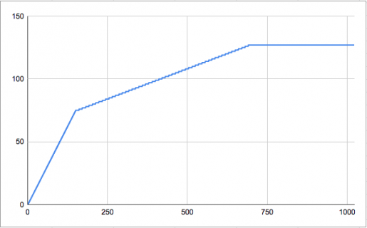

It took longer than it probably should have but after some refreshing on y=mx+b I have a function that does what I wanted. I'm still evaluating if it gives me the results I need at the instrument level. The code below generates 0-1023 of input data and runs each point through the function. The user gives a gain and transition point (below which the gain is applied) and then corrects the slope above the transition point so the output intersects 1023. The gain and transition are sufficiently arbitrary for me for now, you can also put gains below 1 to invert the curve. Feeling pretty good right now!

I realized that by calculating the slope but using (1023,1023) was creating a problem for myself because my sensor never quite gets the full ADC range. I masked this by bringing headroom down to cut off the top of the second slope at some lower value, then scale the output to 127 based on division or the Arduino map function. In this new example I calculate the "run" in rise over run based on the headroom but the rise is still based on 1023. The result is that the second slope aspires to reach 1023 at a lower value, will overshoot, and will need to be capped a bit further down. What is nice about that is the output now clips at the highest useful value and can now be scaled from 10 bits to 7 with a simple bit shift, rather than another floating point division that has to be based on the arbitrary headroom value.
