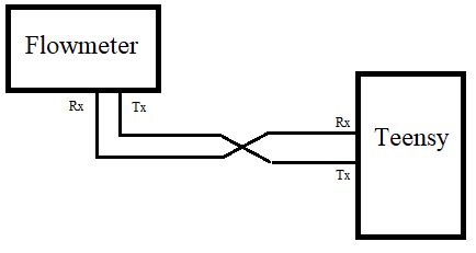

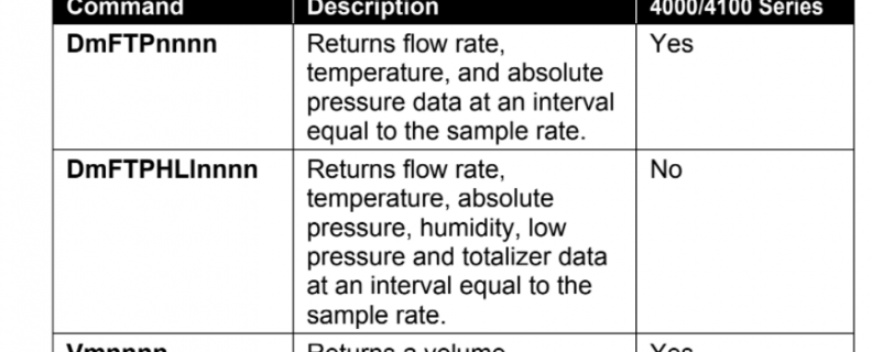

Hello guys! So, my issue is that I'm attempting to send ascii commands and in return I want to be able to read the outputted response of a sensor. For example, I want to send b'DAFxxxx0005\r\n' then in return the sensor should send 5 readings on one line of Flow in LPM. I have Python code I wrote that does exactly what I want between a pc and the sensor just to show more in depth what I want to achieve between the sensor and teensy. (RX = 0, TX=1)

You said NOTHING about actuating the command from the console.
The program that you showed with your post did not do that either.
Anyway there is much contained within the code that I sent you which should allow you to modify the program for your needs.
No i dont want to actuate anything from the console, I just thought yours was doing that. What I want is for the thing to turn on and start giving me flow readings until it hits 85.0 LPM. However, when I turn your code on it does nothing. Nothing comes out on the console at all. I'm wondering if my RS232 to ttl converter is connected correctly. My pinout is VCC - 5v, Rx = pin 0, Tx = Pin 1, Gnd - 0v. On the converter itself it has a male end DB9 and it's connected to the Flowmeter by RS232 Female to USB-A right into the meter.
In theory if my Meter was connected correctly wouldn't this code (see below) return "OK" in the serial console, but rather I get an empty square. I guess where I am struggling is, how does the teensy associate Serial1 to my teensy pin 0 and 1, because if Serial1 isn't reading those 2 pins exactly then i would never see any data. right?
char s;
  while (!Serial && (millis() < 5000)) {};
  Serial1.begin(115200);
  Serial1.write('?\r\n');
  s = Serial1.read();
  Serial.println(s);

did read the datasheet
and the returned readings
have the following format
1.10,1.20,1.25,1.23,1.20<CR><LF>
that mean the code from BriComp needs some changes
or use the command DCFxxxx0005 instead
that will send each sample followed by a <CR><LF> instead (then no changes to the code are needed)
1.10<CR><LF>
1.20<CR><LF>
1.25<CR><LF>
1.23<CR><LF>
1.20<CR><LF>
https://tsi.com/getmedia/92d1aff6-a...8/5200_5300-Command-Set-6011697A-web?ext=.pdf
page 16-17
did also note that the shorter commands
DAFxx0005
or
DCFxx0005
can be used
also the manual is secured
so you can't copy text from it
very annoying
The Flowmeter/TTL Converter Rx should be connected to the Teensy Tx and the Flowmeter/TTL converter Tx to the Teensy Rx.

The flowmeter manual states that there should only be 2 x's on the request readings command.
I need to use the second one. You just replace reading you dont want with an x so in this usecase I want DAFxxxxx0005 and down the road want to use DAFxxxLx0005.

Thi is how my Flowmeter is connected for VCC I've tried 5v and 3.3v to no success and I've tried swapping the Rx and Tx just in case.
That's not a very good photograph it's impossible to see where the wires go due to parallax error - the camera is not pointing straight down.
It is also impossible to see what rs232 to ttl adaptor you are using.
As for the small snippet of code, the while (Serial1.available()) is being executed but that there is no data in the Serial1 port to be collected.
