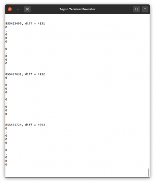

I modified your program slightly to print the elapsed microseconds, so the results are easier to read.
  SerialUSB1.println("Setting up");
  if (SerialUSB.available()) {
    static uint32_t prior_m = 0;
    uint32_t m = micros();
    SerialUSB1.print(m);
    SerialUSB1.print(", diff = ");
    SerialUSB1.println(m - prior_m);
    prior_m = m;
    while (SerialUSB.available()) {
      char c = SerialUSB.read();
      SerialUSB1.println(c);
      if (c == 10) break;
Here is the result when I run it on my Linux desktop with a Teensy 4.1.
The result is slightly more than 4000 microseconds because the code on the Linux side is taking time between the delays. To get more accurate timing, you would need to use more sophisticated delaying on the Linux side which takes into account the time which has been spent running the code, rather than a simple fixed delay.
The Teensy side is very fast & accurate. The imprecise timing you're seeing is coming from the Linux side because you're using a shell script which involves substantial delays to launch programs.
