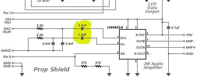

You could use MQS on Teensy 4.0 / 4.1. MSQ creates a PWM-like output with 352 kHz carrier, so it's easy to low-pass filter the signal to get rid of the fast pulsing. Usually just a resistor and capacitor is enough.
You'll need an amplifier between the low pass filtered signal and driving this device, which electrically is pretty much the same as an ordinary 8 ohm speaker. The challenging part is most amplifiers don't pass extremely low frequencies well below 20 Hz. The Prop Shield is no exception. It might be able to work if you increase these capacitors to support really low frequencies.
The Prop Shield already has a 2.2K resistor and 3.3nF capacitor which should block enough of the 352 kHz pulsing, so you can probably just connect the MSQ output pin directly to the Prop Shield pin meant for the DAC output of Teensy 3.2.

You could use the two DAC outputs of the T3.6 to generate a sine wave with controllable frequency and amplitude in the range from 0.1 to 50Hz. You would have to convert the DAC output to a zero-centered AC waveform for your hardware. That might take an amplifier as well as the following simple circuit:
This circuit allows you to mix the output of DAC0 with the output of DAC1 to generate a sine wave with controllable amplitude. Each DAC sends a sine wave of the desired frequency using an interval timer to send the signal value to the mixer. By sending the output of DAC1 in a variable phase relationship to the signal from DAC0, the sum of the two signals will vary in amplitude as you change the phase relationship.
The two DAC output signals are generated by reading output values from a single lookup table which contains the DAC output value for a single cycle of the Sine output waveform. The output values are sent to DAC0 and DAC1. The DAC1 values are read from the same lookup table, but phase shifted by selecting an output value from a different position in the lookup table.
