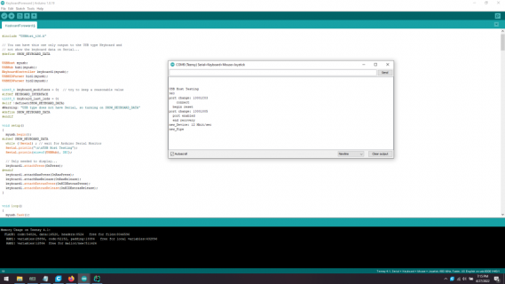

I also uncommented the following in order to display debug information.
#define USBHOST_PRINT_DEBUG
Anyway, when I run the program, I get this at first:
USB2 PLL running
 reset waited 6
USBHS_ASYNCLISTADDR = 0
USBHS_PERIODICLISTBASE = 20003000
periodictable = 20003000
Then when I connect the keyboard, the following shows up:
port change: 10001803
    connect
  begin reset
port change: 10001005
  port enabled
  end recovery
new_Device: 12 Mbit/sec
new_Pipe
And that's pretty much it. (To be honest I'm not sure what to expect in the debug logs, so maybe its totally normal)
I tried running the HIDDeviceInfo example to check if it was just me misusing the library, but it too doesn't find any devices (I tried a lot of different usb devices btw, ranging from usb sticks, keyboards, mouses, etc..)

If you want to know what happens when I run the keyboard example, this is what I get (The keyboard is plugged in, and I'm spamming random keys):

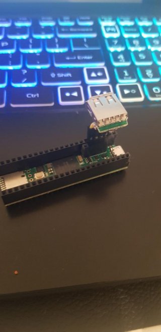

How are you connecting to the Host port ?, "I even attempted inverting D- and D+ just in case" suggests somthing adhoc. Have you tried anything like below. I have a few of these and have good results with the 4.1.
I soldered some jumper wires to a USB A female connector, then soldered pin headers to the teensy 4.1 and plugged it in.
That worked perfectly when I tested it a few months ago on my earlier teensy board (which I tragically ruined while soldering), but it now doesn't work on my new one that I recently got.
Sounds like it might be a electrical connection issue then. Have you checked for dry joints, broken wire, excessive resistance, shorts ? Do you have a scope or Logic analyser so you can see the signal ?
Personally I would use headers as they are easy to solder reliably on the teensy and a flying lead for the USB as you can easily replace it.

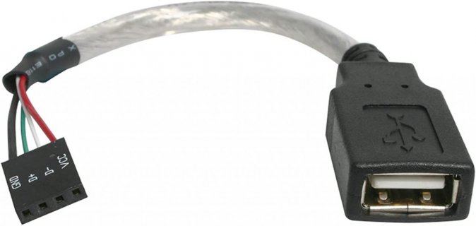

Using a PJRC 5 pin (2 GND) version like p#7 here and it works as in p#2.

Oh looks like you were right about the connection, I stole a female USB type A port from another component, soldered it to jumper wires and now its working :facepalm:
So the old one I made must have been defective in some way
Anyway thank you so much for your support and your time :eek:
