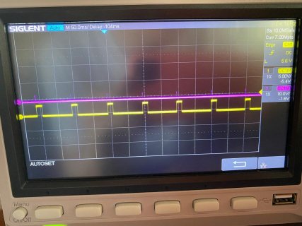

Here's a view of the scope, Input #1(yellow) is Pin 23(input trigger) and Input #2(Purple) is hooked to Pin 21(output trigger). You can see they are triggered at same time, without the delay.

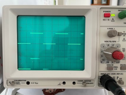

On the oscilloscope, we can see that both signals are in phase:
I think the problem comes from Timer3.start(), which triggers an interrupt immediately.
