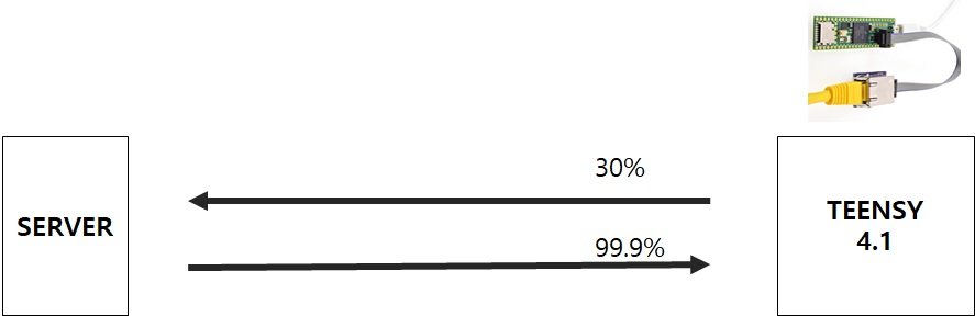

If you look at the photo,
1. When sending, there is a 30% chance of success.
2. Receiving has a 99.9% chance of success.
Why doesn't it arrive well when sending udp packets?
'udp.write' does not work well. Why?
