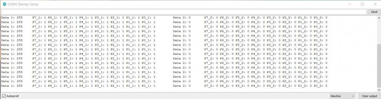

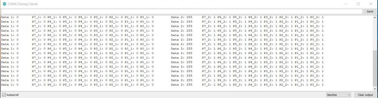

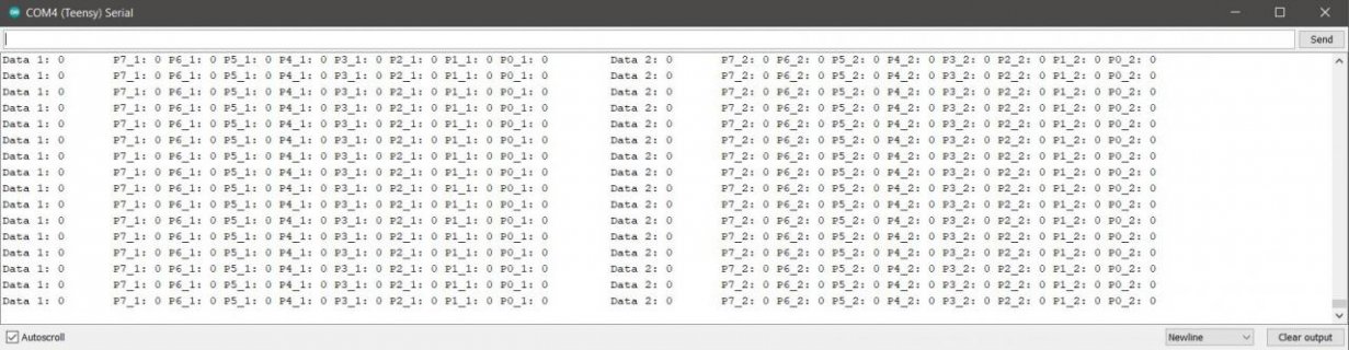

I have a teensy LC and am trying to add two SPI GPIO expanders ICs to it. The expansion modules are the xra1402ig16tr-f and the datasheet can be found here. I have some simple code that I was attempting to use to test and make sure that the IC's were working properly. The code (below) enables the pullup resistors on the ICs, reads data from both ICs every 100ms, and then outputs the data of each bit on the serial monitor. However when I run the code it only returns zero. I should get 255 because 8 input bits are being returned and the pullup resistors are being enabled. The weird thing is that when I comment out the line "data_1 = SPI.transfer(0x80)" but leave all the same wiring I then get a response from the other module and it works as intended. I get 255 and and when I short one of the input pins to GND the respective bit goes low. The same thing happens the other way around; if I comment out the line "data_2 = SPI.transfer(0x80)" I get a response for data_1 = SPI.transfer(0x80) and the IC works as intended.
On top of that, I have taken my multimeter and found that all the pullup resistors on the pins are turning on for both ICs no matter what the rest of the code says. So both are responding to their respective "SPI.transfer16(0x8FF)" in void setup which sets the pullup resistors to HIGH. The same IC's pins won't go high if I comment out its "SPI.transfer16(0x8FF)" or comment out its digitalWrite(ss, LOW) before that. This leads me to believe that my wiring is correct.
