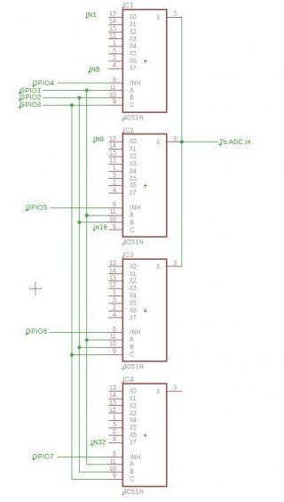

This is how I would wire the MUX chips
Without writing out all the code, here is how to do it (this is not the full program)
int MUXCHIPNUM = channelNumber/8;
int MUXCHANNEL =channelNumber % 8;
//To select the proper mux chip
// deselect all 4 MUX chips
DigitalWrite(GPIO4,HIGH);
DigitalWrite(GPIO5,HIGH);
DigitalWrite(GPIO6,HIGH);
DigitalWrite(GPIO7,HIGH);
// select the right one
switch (MUXCHANNUM) {
Case 0:DigitalWrite(GPIO4,LOW); break;
case 1:DigitalWrite(GPIO5,LOW); break;
Case 2:DigitalWrite(GPIO6,LOW); break;
Case 3:DigitalWrite(GPIO7,LOW); break;
// next select the proper mux channel
switch (MUXCHANNEL) {
case 0;
digitalWrite(GPIO1,LOW);
digitalWrite(GPIO2,LOW);
digitalWrite(GPIO3,LOW);
digitalWrite(GPIO4,LOW);
case 1;
digitalWrite(GPIO1,HIGH);
case 2;
digitalWrite(GPIO2,HIGH);
case 3;
case 4;
digitalWrite(GPIO3,HIGH);
case 5;
case 6;
case 7;
// after doing this mux selection, delay 10-100 us to allow the ADC input to settle before reading ADC
cheers
OOPS- I forgot to draw a line from IC4 X line to the X lines of the other 3
