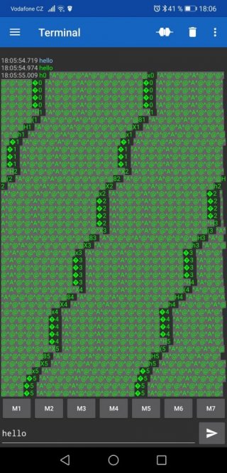

I am testing this code:
#include <SoftwareSerial.h>
#define RX 0
#define TX 1
SoftwareSerial sserial =  SoftwareSerial(RX, TX);
String data;
#define BUFFER_SIZE     (100)
String buf[BUFFER_SIZE];
  sserial.begin(9600);
  for(int i=0; i<BUFFER_SIZE; i++) {
      buf[i] = "1";
  while(sserial.available()) {
    char c = sserial.read();
    if (c != -1) {
      data += c;
      if (c == '\n') {
        Serial.println(data);
        sserial.print(data);  [B]// no problem - I can see text on my mobile[/B]
        sserial.write((char*)buf, sizeof(buf)); [B] // I see just nonsense chars on my mobile[/B]
        data = "";
I can see correct text with sserial.print(data);
With sserial.write((char*)buf, sizeof(buf)); I see nonsense - see picture:

As I said earlier if you use write you are sending 4 BYTES of BINARY data. If you used print that binary data is converted into MANY MORE BYTES is ASCII text.
    uint32_t num;
    num = 1094795585;    // = 0xAAAA
    Serial.print(num);  // will print ASCII representation of num - 1094795585 to the screen / serial port - 10 BYTES
    Serial.write(num);  // will print the binary representation of num - A to the screen / serial port

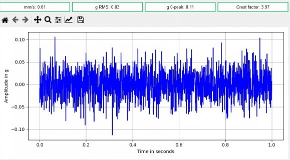

Floats are numbers from adxl accelerometer and 24 bit adc converter. I need maximum precision.
Now I use serial communication via USB and it is OK (30k floats in 0.2 second), but lot of noise via cable and will be much better in field without cables.
Or will be better use wifi instead bluetooth?

I measured low noise on my PC:
And much higher nosie with my laptop and tablet:
Now I am pretty sure it will be not possible to send my data via bluetooth so I have to solve the noise.
