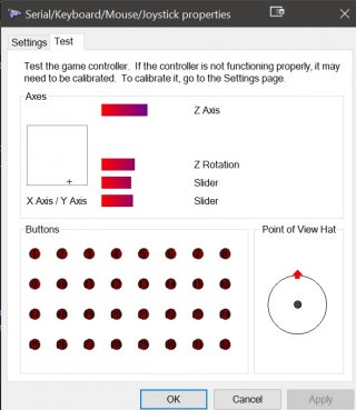

When I look at the USB controller settings the teensy is labeled as
'Serial/Keyboard/Mouse/Joystick' and the status is OK

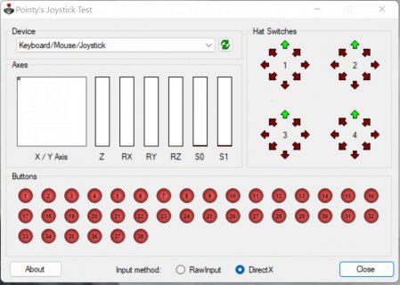

But the properties control panel shows the 'point of view hat' pushed forward.
As you can see in the code, three buttons are detected as joystick buttons and pressing these properly lights up the correct red lights on the USB game controller panel.
How can the point of view hat be 'stuck' in the forward position?
How can I troubleshoot this?
Interestingly, in the post here:
https://forum.pjrc.com/threads/29320-Teensy-3-1-Button-problems?p=80275#post80275
They talk about windows 'making up' values for axes that are not initialized. Setting the axes to 512 corrects this. But in that SAME post there is a picture of the hat being activated in the forward position though the problem is not addressed.
The reason this is a problem for me is that I have a tactical flight analysis program (TACVIEW) that continually scrolls left unless I disconnect the teensy. I am guessing that the forward activated hat is being interpreted by the program causing it to scroll left.
Maybe try setting the hat value...
My gut is it is defaulting to sending a 0 direction: Sort of maps 0-360 degrees (int) into 0-7 values. You might
try: joystick.hat(-1);
Which if < 0 will set hat to 15... And see if that helps.
Hey! sorry to necro this, I am having this issue using the extreme joystick. I have usb_desc.h set to use the bigger version, I only have my buttons programmed but the 4 hat switches and the XY axis are showing as having constant input, I have tried to set my hat values to -1 and X,Y positions to 0 but I can't get it to work. Is there anyway to just straight up delete the sliders, hats, and XY axis? or atleast get them to show zero input since they are not part of this project?
I will say, I am very new to this, and this code is from another person, Stefan, that I have adapted to my use. The code was originally designed for use as a keyboard device. Buttons work excellent, just need to get the extra inputs taken care of.
Edit: The last 2 functions isKeyDown and releaseLayer are not used but I haven't deleted them cause they are never called.

Note: I am not seeing anywhere in the code posted that sets anything but the buttons.
That is, I am not seeing something like: for (int i=1; i <=4; i++) Joystick.hat(i, -1);
ditto for the others.
If it were me, I would probably try setting X, Y to probably 512, maybe some of the others as well, but then set sliders to 0
As for removing things? Probably? BUT, that would require an understanding of the HID data, and rules like the number of total bits in a message must be multiple of 8...
Also unclear to me what the joystick tools would do, if some of the basic ones here were not defined.
I'm not trying to have any joystick axes, sliders, or hats, just a button box that uses joystick buttons.
I hadn't set the hats or axes as of that post, but I've since learned a bit more!
my project is a 6x6 keypad with a 7th row and 2 more buttons for a total of 38 joystick buttons.
I'm setting the hats and axes that I'm not using in the void setup(). I'm not even sure what I need to set in there and what I can just leave out since I'm not even using any of the hats, axes, or sliders.
Thanks for your time

  /*Set Hats to center.
  * Setting a value out of bounds ie >360 works to center hat input.
  * I think this is because the header file sets values <0 as 0 but not
  * values above 360.
  Joystick.hat(1, 361); //For some reason this is Hat #4
  Joystick.hat(2, 361); // This is Hat #3
  Joystick.hat(3, 361); // This is Hat #2
  Joystick.hat(4, 361); // Hat #1
  //Set axes to center
 // This doesn't work dot is still green in the upper left corner of the X/Y axis
  Joystick.X(512);
  Joystick.Y(512);
  //Set joystick send mode
  Joystick.useManualSend(true);
