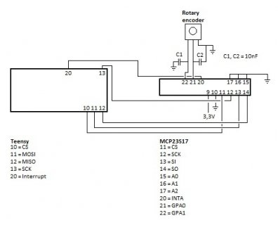

I am testing an MCP23S17 with one rotary encoder for a bigger project. My intention is to Serial.print the inputs of the rotary encoder as a first step of testing. Unfortunately I get nothing, and therefore I'd be grateful for feedback where I'm going wrong, in particular the configuration of the MCP... Thanks in advance!
The wiring looks like this:

I don't see any SPI.beginTransaction() in your program to configure the SPI settings.
Even if you intend to write all code from scratch, why not at least give a known-good library a run to check whether your hardware is connected properly?

Thanks for your feedback. I edited the code, but unfortunately no results:
I have tried alternatives to this code, for instance the adafruit MCP23xxx library. Regardless of using a well established library or using the code above, my conundrum is that i need guidance to configure the expanders IOCON and PORTA/B registries in either case. I understand that a library shows how to configure the hardware, my question regards what settings I need to make for my particular setup. And since there's a risk that my wiring isn't properly setup I wind up in a catch 22 situation. Currently there are too many combinations of variables for me to trial and error my way to a solution. This is why I ask about both code and wiring.
Another point regarding your schematic, I believe that the Reset pin should be tied to VDD, and not floating. this is how I run mine. The datasheet has "The on-chip POR circuit holds the device in reset until VDD has reached a high enough voltage to deactivate the POR circuit (i.e., release the device from reset)."
https://ww1.microchip.com/downloads/en/devicedoc/20001952c.pdf
You're absolutely right, good call! And thanks for your guidance for the settings, I'll look into it today!
