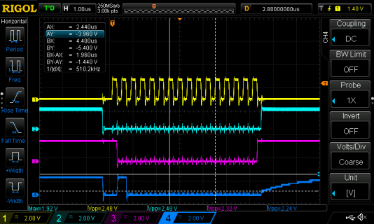

My complication is that when I send a read command (0x80 to read register 0x00) from the Teensy to the ADC and scope the ADC's SDO line, I receive an incorrect response (expect 0x18 but get 0xFF). When I plug in the interface, run the evaluation software, and send same command while scoping the SDO line, I get the correct response (0x18).
Scoping Teensy SPI interface
yellow = CLK
teal = CS
purple = MOSi
blue = MISO

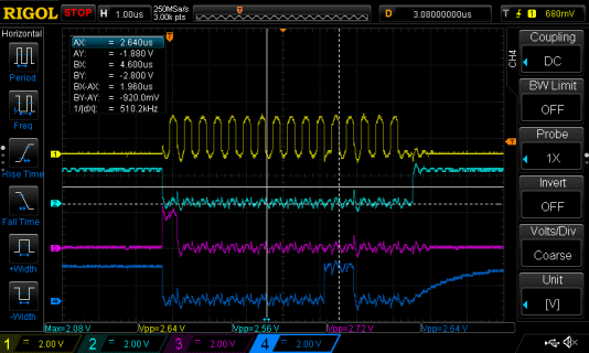

Scoping Interface Board SPI interface
yellow = CLK
teal = CS
purple = SDI
blue = SDO

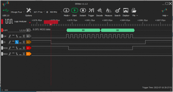

Ran your code on a Teensy 4.1 and the logic analyzer shows the same as your first picture [with the exception of the MISO line since I don't have an AD4134 here].
Can it be that the eval software sets a number of additional AD4134 registers that you are not aware of?

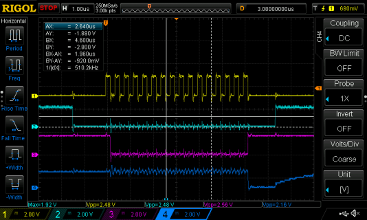

Thank you, @PaulS, for the suggestion. I've looked through the datasheet and it doesn't indicate additional setup. I also scoped the first 2 seconds of the SPI lines after evaluation software bootup, and the only activity is a read of every register on the ADC.
I am now powering the Teensy and lower side of the level translator using 5V and 1.8V outputs from the evaluation board (in case there was a grounding issue), and the high side of the level translator using the 3V output from the Teensy. There is an output difference but still incorrect.
Scoping Teensy SPI interface after rewiring to use 5V and 1.8V voltages from ADC evaluation board
yellow = CLK
teal = CS
purple = MOSi
blue = MISO
Two observations that strike me as irregular:
1. There is ADC-SDO (Teensy-MISO) traffic in the first two bytes, instead of the latter two bytes.
2. The Vpp of this line is ~10% smaller than the other signal lines.
Thank you again for your input.
