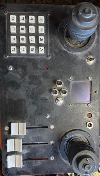

teensy axis also sending numerical digits to windows.
skypickle
I have a Teensy 4.1 with 5 buttons mapped and 6 axes. It also runs a small display which I can change with two buttons so I can have a readout of my controls for various aircraft. They work as intended except two axes seem to do more than I ask for them.
The potentiometers mapped to the X and Y axis correctly move the little cross in the windows usb controllers control panel. All axes and buttons were calibrated. However, if I open up a text editor and spin the X axis dial all the way left I get a '4' in text editor. Spinning right gives a '6'. These numbers only appear at the extreme of excusion. The Y axisa dial gives '8' and '2'. Somehow these axes are being interpreted as the num pad?
Here is the code :

Is this a known windows bug?
Might help to know things like what version of Arduino are you using, and likewise Teensyduino.
Likewise what version of windows you are running.
Also maybe might debug it a bit in your code, where you set the X, and Y values, maybe print out the values are at the extremes.
Arduino 1.8.19
Teensyduino 1.56
