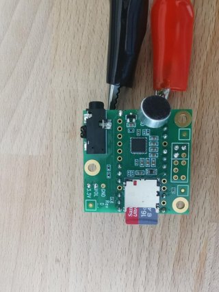

I have an electret microphone directly connected to the audio shield. I am supplying the Teensy by an external power supply.
The overall setup looks like this:

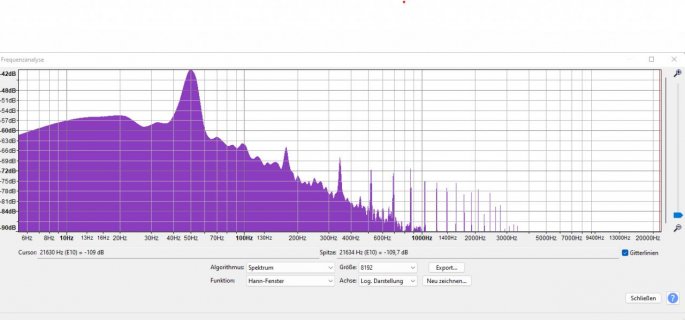

The frequency spectrum from Audacity looks like this:
It seems like I have Problems with 172Hz and multiple frequencies.
This is exactly the frequency for the SD Card Write operations. Every 5802µs...
I am using a SanDisk Ultra 16Gb Class 10 Micro SD.
Any Ideas what I am doing wrong and how I can get rid of these frequencies?
I already tired to power the teensy from a battery. This is only reduicing the 50Hz and multiple Frequencies from the mains, but has no significant impact on the hearable noise.
