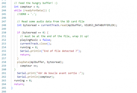

Hi there,
Background of the project :
I'm working on a project where I alternately switch from playing audio to recording audio with the Adafruit VS0153 breakout board. I had a program working fine using an arduino UNO, in exception of the loading time of the plugin made for the the audio recording (I managed to reduce the loading time by half by modifiing the library, but it was still too long). Therefore i swiched to a Teensy LC i had laying around, hoping the 32 bits capacity would make this loading time faster.
Problem :
After adapting the program for the teensy LC (basicaly just changing the pins and the source library), nothing really worked anymore. Main thing beeing the audio started to play and stopped right away.
Investigations on my side :
- The Player simple exemple works great
- When diging in the library I notice that in the feedbuffer() function, the "while (readyForData()) " get called repetedly for from 2 to 32 time when used in the Player simple exemple, and only once for approx 150 times when used in my exemple. (see picture)
- as soon as I add the musicPlayer.begin() function in the main loop in the player simple I get the same symptoms as in my own program (even if I put an if condition to make sure that the musicPlayer.begin() will only be called if the musicPlayer wasn't already done)
Question :
As I need to alternate between recording and playing, (and therefore having to re-redo a musicPlayer.begin() when I'm swiching from one to an other). Is there a way I could make the teensy accept the musicPlayer.begin() function in the main loop ?
Thanks in advance,
Sorry, I realised I uploaded an old version of the code with mistakes, here is the correct one :

Sorry, I don't have your setup, so cannot test.
But the things I would try include moving the calls:
  musicPlayer.setVolume(20, 20);
  /***** Two interrupt options! *******/
  // This option uses timer0, this means timer1 & t2 are not required
  // (so you can use 'em for Servos, etc) BUT millis() can lose time
  // since we're hitchhiking on top of the millis() tracker
  //musicPlayer.useInterrupt(VS1053_FILEPLAYER_TIMER0_INT);
  // This option uses a pin interrupt. No timers required! But DREQ
  // must be on an interrupt pin. For Uno/Duemilanove/Diecimilla
  // that's Digital #2 or #3
  // See http://arduino.cc/en/Reference/attachInterrupt for other pins
  // *** This method is preferred
  if (!musicPlayer.useInterrupt(VS1053_FILEPLAYER_PIN_INT))
    Serial.println(F("DREQ pin is not an interrupt pin"));
into loop as well, within the same if block as the begin... After the begin
Hi KurtE,
You spotted the right point, I just tried it and it worked with the Interrupt initialisation into the loop.
Thanks a lot !
I still don't understand why it worked on the an ATMEGA 328 and not on the Teensy LC but I guess the interrupts work a bit differently on both µC
