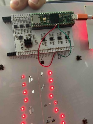

Hi, I'm working on an audio project where I am using an IS31FL3236A I2C LED driver alongside the Teensy 4.1 audio library with the CS42448 TDM codec.
When running my code I get the expected visual behavior, but with a lot of I2C transmit errors, then at a certain point the I2C just stops working entirely and returns an error for every write. I have used the Audio library alongside i2c_t3 with the same LED driver before and this worked really well, but I'm now having to switch over to wire on 4.1 and it's creating a lot of problems.
In order to get around the blocking writes that Wire does I am doing one write every millisecond, and updating the LED buffer every 40 milliseconds (for a refresh rate of 25hz), so that timing critical stuff can happen between writes.
Here is my project code, any idea what might be causing this? Would the Teensy4_i2c library improve this behavior in any way? (wanted to avoid using this because of conflicts with the audio library, but willing to try...):

Ok, this is a longshot... but try adding a 22pF to 100pF capacitor between the SCL pin and GND. The exact capacitor value doesn't really matter, as long as its good quality ceramic (pretty much all capacitors in this range will be) and the leads are reasonably short. But don't stress an small difference like a 1/4 inch (6 mm) in lead length.
Recently we discovered I2C slave mode was sensitive to high frequency signals like MCLK. With TDM you have that on both MCLK and BCLK. I don't know much about this LED driver chip, but I see it mentions 3 MHz clock, so maybe it's contributing high frequency noise too? Might be a perfect storm of this sort of high frequency coupling. Maybe.
So far this problem has only been confirmed with slave mode. Looks like you're using master mode. I did say it's a longshot, but if you have any spare capacitors in that range, it's worth a quick try. Please let me know if it makes any difference?

Thanks for the reply! Just tried with a 100pf cap and I'm getting the same results. I did find a temporary workaround in code, by resetting the Wire1 object and the IS31 led driver whenever I get a wire error, but would like to find a better solution:

Did you add pullup resistors on the Wire1 pins?
Yes. I rechecked my schematic, there's a 1k pullup on each line. Which I realized is different from the recommended 4.7k. Could this be the issue or is that kind of a replaceable value? Will have to check when I get back to the bench.
Changing to 4.7k did not help, if anything issue is worse after doing so...

Update to this, updated the program to track the number and frequency of I2C errors. It appears to run indefinitely when I have the I2C restart when an error is detected, but I'm getting I2C errors at a frequency of roughly 1 per second:
I2C_Error: 2 - At Timestamp: 5844824
Error Count: 5492
Average Error Rate (ms): 1064
attempting wire reset

It seems this forum can't really handle images so here's a git repo with everything. Photos of the working T3 board and the not working so well T4 board + schematics for everything, let me know if this suggests anything: https://github.com/hhaudio/I2C_T4_Documentation
As I stated before, I also tried jumping a T3 to the headers on the T4 board using M to F jumper wires, and the old I2C program worked with the IS31 without issue (even with the hacky jumper wire setup), so it seems like this is definitely a T4 specific issue rather than something layout related.
Also tried jumpering the SCL and SDA pins directly from T4 to the PCB just to make sure the headers weren't the issue. Still the same results:
Also found out how to upload photos haha, they just have to be real small... :cool:
I'm guessing U5 on the large bottom board is the IS31FL3236A chip?
Is Teensy 4.1 providing all the power to run everything? Or is another power supply involved somehow? Just trying to get an idea of what will be needed. Since this problem doesn't happen with any of the many I2C devices I have, there's no way I can do anything without getting the hardware needed to reproduce this problem.
For now it’s just powered via USB 5V. I’ve also tried providing 5V from an external supply but it doesn’t make a difference.
Actually looks like I figured it out by adding an additional coupling cap to the 5V line entering the IS31 IC. No longer getting I2C errors with the additional filtering present. Maybe worth noting however that T3.2 worked whether the coupling cap was present or not, whereas with T4 they need to be present &#55358;&#56596;
