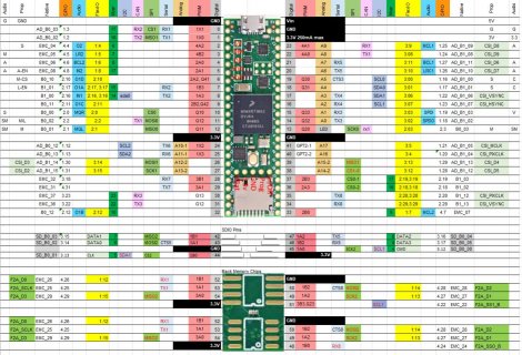

Following on to what Paul mentioned.
Yes the Teensy IO pins are on GPIO ports: I often refer to my own cheat sheets on what port/pin each one is on
Like:
Note my documents show the GPIO ports as 1-4 which is standard mode, however they are switched to fast mode which is 6-9 (1->6)
If you have not already downloaded the Reference manual for processor, you can from the website: https://www.pjrc.com/store/teensy41.html#tech\
If you look at chapter 12 you will see there are registers to set, clear, toggle pins in a port (DR_SET, DR_CLEAR, DR_TOGGLE)
Note for the simple cases like Paul mentioned, like digitalWriteFast(13, HIGH) will convert into one instruction using DR_SET on the specific port/pin
