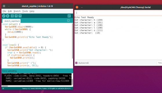

Bug: SerialUSB.read is not functional
This has also been added as issue #652 in the cores GitHub repo.
There appears to be an issue with the USB serial driver supplied with Teensyduino. Some critical state info. is not being transmitted by the Teensy driver to the Linux host, which in turn causes the Linux cdc_acm driver to block sending any data to the Teensy.
In other words, the SerialUSB only works in one direction: from Teensy to Linux.
The test program is attached.
The test program was also used with an Arduino Nano 33 BLE Sense, and a Raspberry Pi Pico, with no issues. Same test environment.
Ubuntu Linux 18.04.6
Arduino IDE 1.8.15
Teensyduino 1.57
Board: Teensy4.1
USB Type: Serial
Speed: 600MHz
Optimize: Debug (also Faster tested)
Serial port: /dev/ttyACM0
Steps:
1. Load program onto board
2. Open Arduino IDE Serial Monitor
3. Echo Test Ready appears in Serial Monitor
4. In the Serial Monitor input area, type any character and hit Return
5. Continue step 4, noticing there is no output in the Serial Monitor. Eventually the entire Arduino IDE will stop responding until the Teensy is powered off.
This behavior can also been seen at a Terminal command prompt with the Teensy powered on:
echo hello > /dev/ttyACM0
The command will simply hang until the Teensy is powered off.

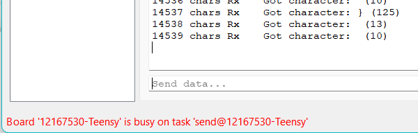

Odd - added a char Rx count display - and using TyComm upload of the Source file and some characters I got this:
No more LED blinks and No more reply from Teensy.

I can use Loader and Button to Upload and the code starts - but I can no longer send any characters.
C:\T_Drive\tCode\FORUM\SerailFailTest\SerailFailTest.ino Sep  4 2022 03:52:57
Echo Test Ready
Even after repowering Teensy and also the HUB?
Seems I did something to TyCommander? Closed and restarted TyComm and on two T_4.1's BOTH have taken over 20K characters.

I built on Ubuntu 22.04 64bit, using Todays Arduino 2 nightly build with 1.57 Teensyduino.
I unplugged the T4.1 after the program uploaded and opened terminal and did the:
The terminal window did not hang, but the Teensy was left with the LED turned on.
Which implies it still is looping waiting on:
[COLOR="#FF0000"]  while (!SerialUSB) {
[/COLOR]
i.e. the echo > does not satisfy the magic Serial cookie.

Edit: Reran with 1.8.19 open serial monitor, and then did the echo and it appeared to work.
